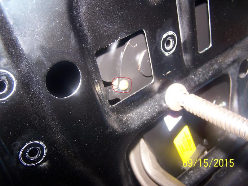

Also the Nu Relic door window regulators do not have an adjustable down stop built in. I ended up drilling and tapping a 1/4" bolt in front of the stop because the window would roll down to far below the cat whiskers. I called them because the directions say "if the factory regulators had adjustable stops, the Nu Relics do also". It was not the case so you should look at them as yours may not also. Mine needed to stop 1/4" sooner so that was my fix. Maybe you can come up with another. I had to drill and tap mine in place as I didn't want to take the door apart to get the regulators out. If I were you, I would at least drill and tap the hole just in case you need it before you install it. Here is a pic of what I needed to do.
