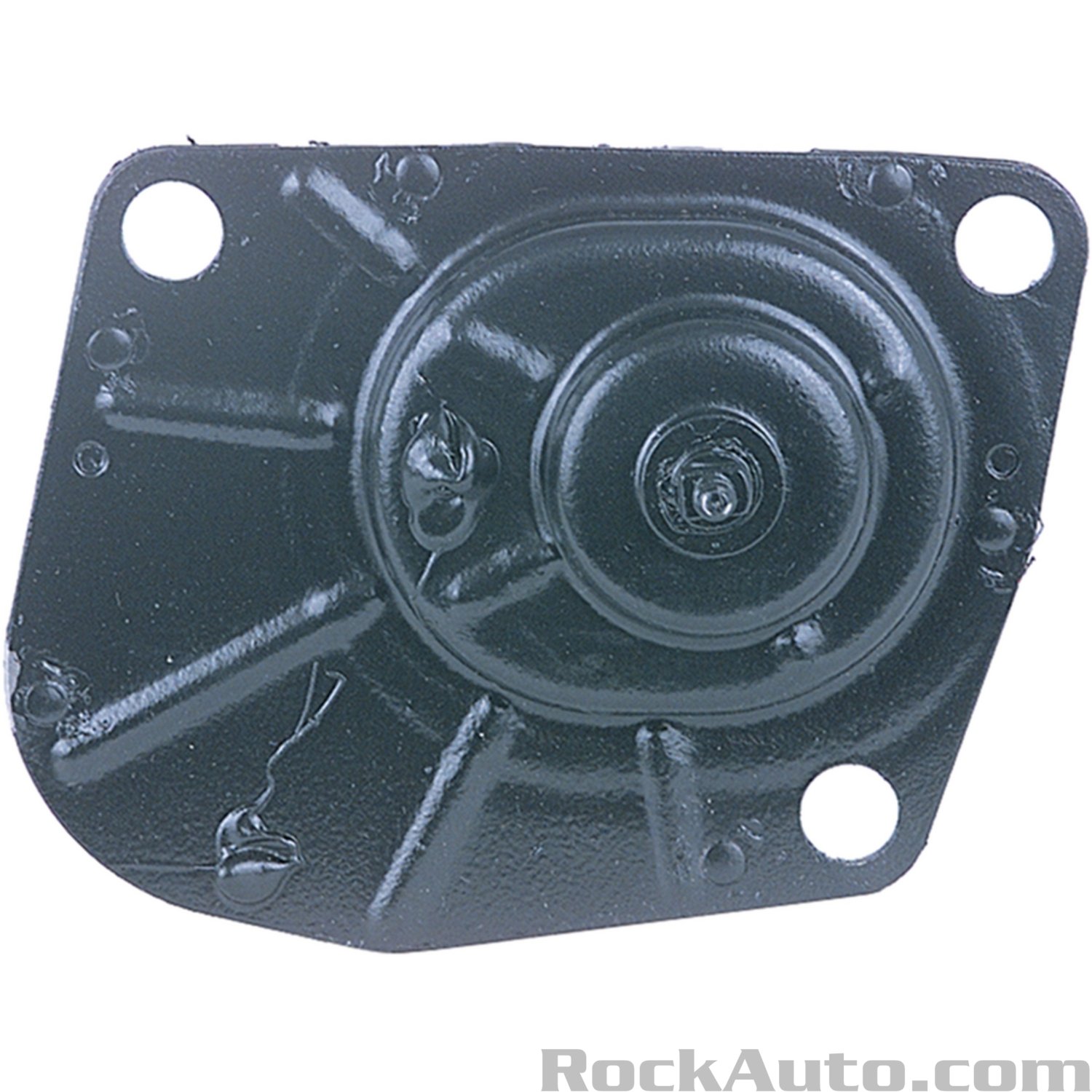

The wiper motor works great, I need the link from the motor to the left side pivot. The nut came loose and the motor shaft end ate up the slotted opening on the drive link.
Weld a small hole washer onto the backside and file out the flats you need?
A picture of the end of the linkage and the damage would be helpful - might be very easy to weld in a patch as stated by DAKO . . .
