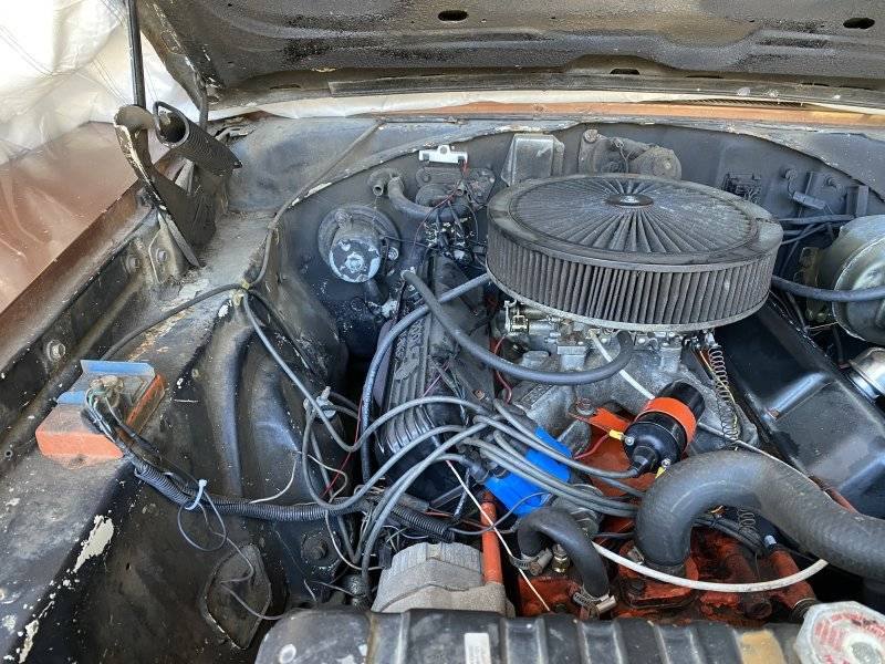

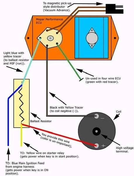

First off you said you have points. Secondly you have a electronic ignition box of the inner fender passenger side. Something seems weird. Im not sure if you can use an orange box with points. Someone will chime in with better knowledge. But here is a good place to start. Check out this diagram on the orange box and see if you have anything that matches.
Looking closer at your picture I see the electronic distributor wire connector just below the valve cover on the left. So it seems you have an electronic distributor. You could pickup a new ECU which is fairly cheap. Thats the orange box. @HALIFAXHOPS usually has some good used ones or new old stock ones for sale. But do check the wiring according to the diagram below instead of throwing money at the issue. Check this thread for his ECUs FOR SALE - ECU's

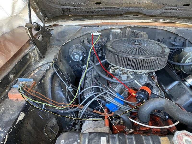

This is your picture I edited with a crayon and my 5 year old self.

First off, that sure is a mess of an engine bay! Holy cow, man...I would have addressed that before I drove it out on the road.
I see a GM alternator. You were not kidding, the prior owner sure did some weird stuff to that car.

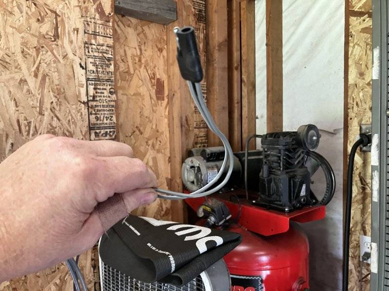

If the distributor has two wires and a terminal like this on it, it is electronic. If it has one wire, it is a points distributor.
View attachment 1792849 This is your picture I edited with a crayon and my 5 year old self.
It looks as if the prior owner installed a GM 10 SI ALTERNATOR. Hopefully, it's field is connected correctly to the Mopar electronic voltage regulator. Most later model GM alternators used an internal voltage regulator and the field voltage is controlled via the internal voltage regulator. You appear to be using the Mopar EXTERNAL voltage regulator (the silver box to the right side of the ballast resistor)...and the jumble of wires behind the alternator are confusing and maybe connected incorrectly....may to contribute to your difficulties......just an additional thought.....and for what it is worth, it looks as if the car HAD factory A/C installed and the heater has been disconnected and the hose connections have been looped although not necessary because the when the thermostat is closed, the coolant is bypassed thru a cored hole in the water pump housing, below the thermostat. You are correct, the engine compartment needs straightened out......
