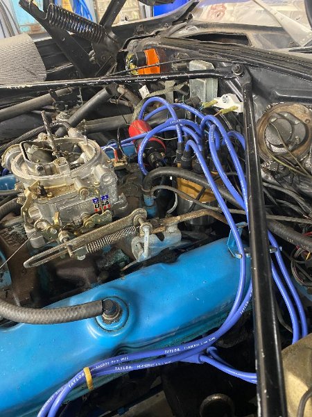

Not a stock dizzy either. So what system do you think that you have?
Distributor looks like a Firecore?
Agree with Canadian1968, you have the "Orange Box" Mopar electronic ECU on the firewall. I also would agree that does look like a Firecore brand distributor. I'm running one on my 383. I would try a stock coil and have the Ballast resistor in series like it was originally. You might want to measure some voltages. In a stock system, with ignition key switch in the "crank" position, both sides of the ballast resistor should have full battery volts. In the run position, the coil or the other side of the ballast should have about 2-3 volts less than full battery. Don't think you need upgrade anything. Make it like original is a good place to start.
It sounds like the classic Piss poor ground at the ECU to me. If you have a digital ohm meter, test between neg post on the battery and ECU case. I'm betting you get a high reading. Anything much over .5 ohm will cause the issues you are dealing with. Sitting alongside the road with a overheated coil and an open circuit on the transistor in the orange box until it cools down and lets you go for a while again.

I'm not sure...After I pulled the car out of the middle of my driveway (we were going to lunch with my dad) it was my snap thought as it acted just like it did when she left me on the road....All the comment here are great.....I'll do some more playing with her today. Never head of a Firecore but it looked like an HEI distributor....I guess it like a Pertronics? I'll try the original set up today and see how it goes
It also has the appearance of an FBO dizzy, but the FBO bypasses the ballast and has a 1.5 ohm coil.
I went in and re-wired everything back to original through the block and she fired right up....maybe the direct 12v overwhelmed the ECU? Anyway, I drove her for 30 minutes, 70 mph on the highway and never a giggle. Got home and laid a hand on the coil (picture) and it was not as hot as the engine which I would say is a good sign.....many thanks for all the help!!!
