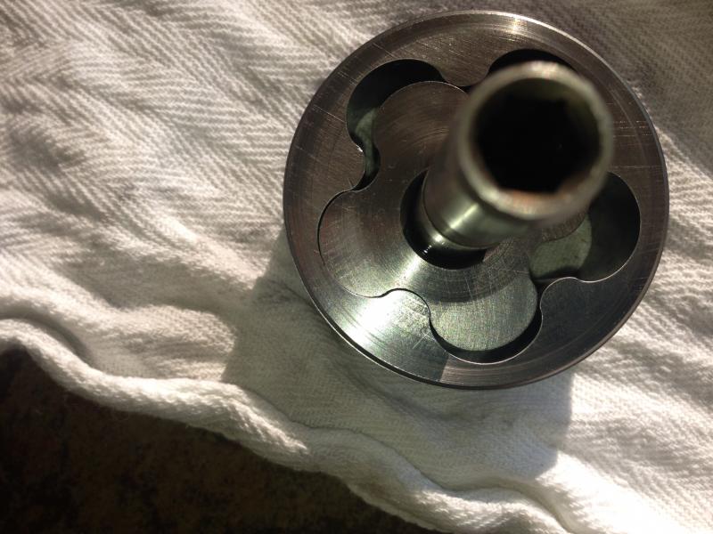

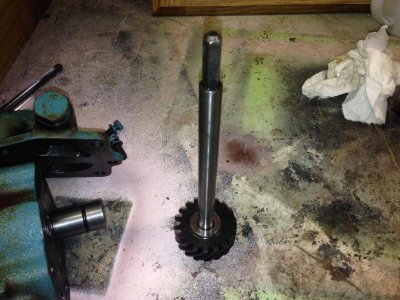

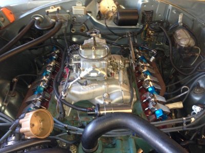

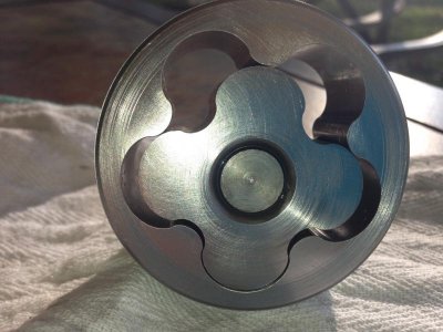

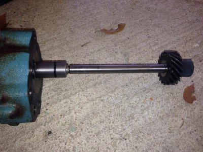

I posted a couple days ago about having no oil pressure. Had the car out and everything was fine. A couple days later I started the car and zero oil pressure. Was suggested that I check the shaft that turns the oil pump. Pulled that apart and it looked good to me.(see pics) Got a priming tool and hooked it up to the cordless drill and had my wife video the gauge. It when up to 20 and drill needed to be put on higher setting. It went up to 40 psi which it normally runs at. Put everything back together and it ran fine, 40 psi, took it down the street and it was fine. Two days later I got my classic motor oil delivered and changed oil and filter. Started it up and zero pressure. Pulled distributor and gear out. Tried to prime it (counterclockwise) and it would not prime. Dipstick showed full. Also put oil in new filter before installing. I guess my next thing to do is drop the pan and check pickup and maybe replace the oil pump. I am not a mechanic and can use any suggestions anyone has. If anyone is in the Baton Rouge area I can use a good mechanic. I will attach some pictures to see if anyone sees anything. I also pulled the valve covers and everything seems ok in there Thanks Jim a.jpgb.jpgc.jpgd.jpge.jpg
I take it you have no oil up to the rockers ? If you do, it's possible to have a faulty oil gauge system. Gauge, sending unit or related wiring. I'll give you a little tip. Pack Vaseline in and around the oil pump vanes, when ever you replace, or just disassemble the pump. You will achieve pressure much faster. And don't use any other type of grease, the pump won't prime. Ask me how I know. Keep us posted.

Any grease will work, including oil, but an engine assembly lubricant is best as it will dissolve in oil. I like to pack pumps with white lithium. I squirt it in, turn the rotors, and install pump. Engine assy greases like white lithium, assy lube, etc are better as they dissolve in the oil. Regular grease won't or is difficult to do. On a side note, I don't use Vaseline as it won't necessarily dissolve in the oil.

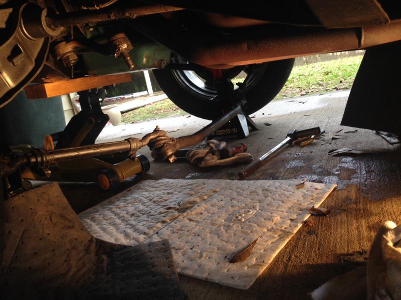

I have always used a wix filter. This time I have a Nappa filter. The gauge is mechanical. Right now I have drained the oil and have the car up on jack stands. I was planning on dropping the pan as soon as I have a day off. I also dropped the steering link so I can hopefully drop the oil pan. Maybe I should just buy a new pump first. Thanks

With your valve covers still off, but oil filter on, try priming the oil system. You should get oil up to one side, or the other, at the rocker arm shafts. Normal deal is get oil to one side, have to rotate the engine a little, to get oil to the other head. If you get oil at the rocker shafts, you should be getting oil to the oil pressure port, where the gauge gets it's reading.

I used axle bearing grease just once, and had no oil pressure. Cleaned the pump of the grease, used Vaseline and had immediate oil pressure. I think the grease first used was just to heavy. I rebuilt a number of engines over the years, both professionally and as a hobby. Not that I'm no ways an expert. I just do what has worked in the past

You showed pics of the oil pump drive shaft. The drive gear for the shaft, that meshes with the cam gear, any chance the drive gear on the pump shaft is loose?

No leaks. The shaft and gear are tight. I use 15/40. My neighbor and I looked at the prv and it looked good. The spring was in one piece. I bought a new pump and will install that as soon as I get time. I also have the car up on jack stands ready to pull the oil pan if needed. I dropped the steering linkage so I can get the pan off. I guess if the new pump doesn't work the next thing to do is drop the pan and check the pick up tube. Any tips on removing the pan would be appreciated. Thanks
