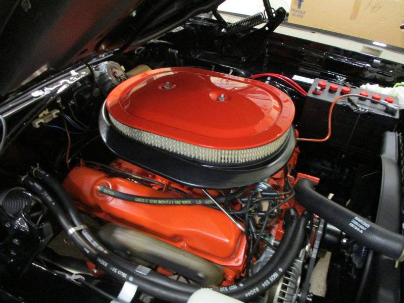

First two pics show what was done from the factory.......The last pics is the best I could find, the car is so black its hard to show....If the car wasn't at the museum about 4 hours away from me I would snap a pic...
