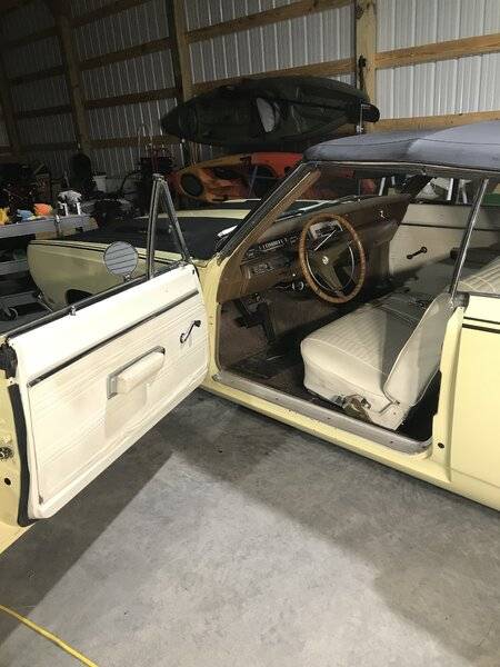

I need some help with the correct interior colors. The car is a 69 Y3 convertible. The dash, A pillars, steering column/wheel, and front kick panels are brown. The seats, doors, door panels, rear side panels have all been painted white. The fender tag has H2H (interior white & tan) and also T7 which I believe is brown. With that information, what parts should be brown and what should be white? I pretty sure I remember the rear panels being brown when I was a kid. Thank

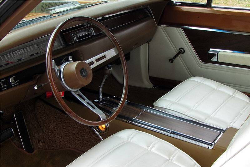

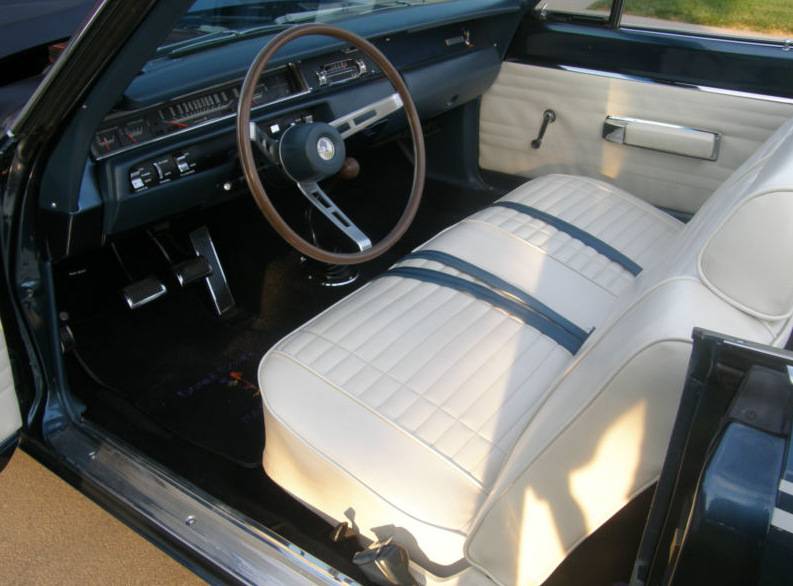

This is a bucket version ,,,,BUT Similar to this ( and FYI, Kick panels were NEVER white )
Again, this should give you the idea. Just replace the blue with tan on your car

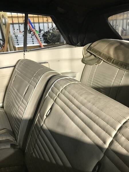

Thanks for the information. This is what I remembered a kid before my dad repainted it as well pointing me in the right direction. This is what it currently looks like. Thanks
D40F734C-E77E-4177-804E-E5AAD4D709A8.jpeg 75E8F3A2-3251-4077-94CD-E85D2520D110.jpeg
