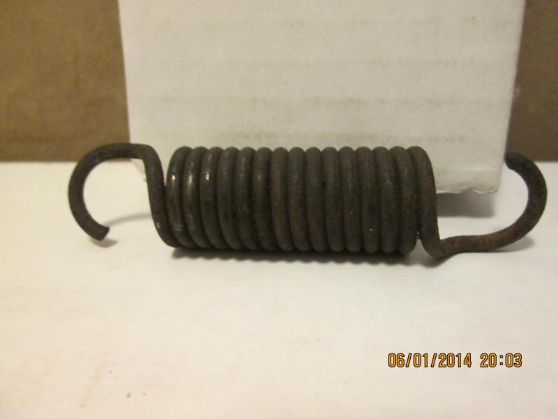

Hi group
NEED HELP FINDING BRAKE SPRING CALLED STAR WHEEL LOCK SPRING what the service manual call it. it has 11 X 3 INCH brakes FOR 1969 GTX
rear brakes it has manual adjusters all parts store and rock auto only has listing with automatic adjusters springs which is not the same. this hold the bottom of the brake shoes together and lock the adjusters so they can't turn. the spring is total is about 3 1/8 long
thanks

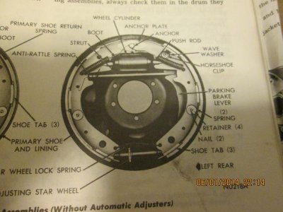

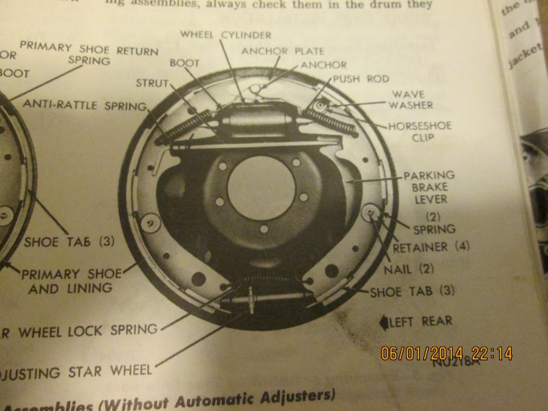

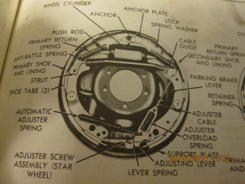

here the diffance between automatic and manual adjusters
order a kit for 11" manual adjusted brakes, not self adjusters or 10" brakes...they are in the kits, you just need to find someone that can look up parts correctly
