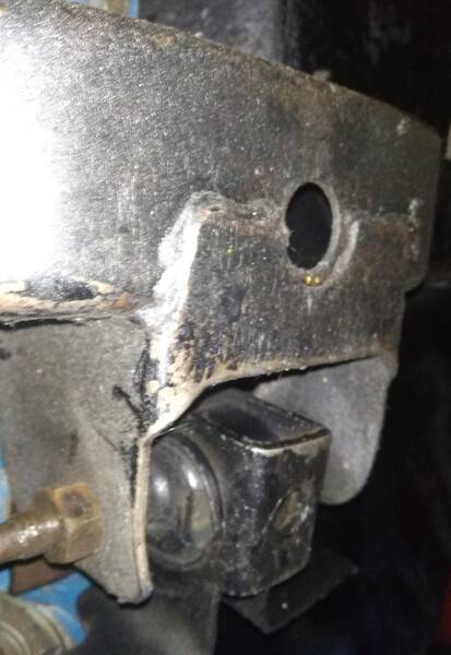

Hi I would like your help identifying this transmission mount.
I have on my 71 satellite a tf727(supposedly) the oil pan is the proper one and the length seems to be the right one but the trans mount seems to be for a 904.
Can you help me
Can you help me
Mount should be slotted where it bolts to transmission to give some back and forth movement.
Okay I wasn't sure because I was under the impression that the "cubic" mount was the standard one for the tf727.
Thanks for the clarification.
The square style was pre 1971. They changed to the spool type mount in 1971.
