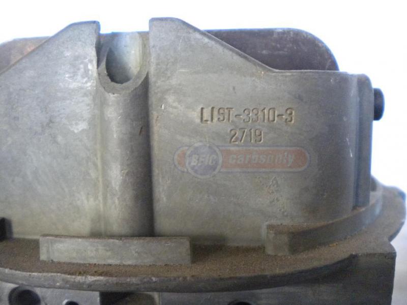

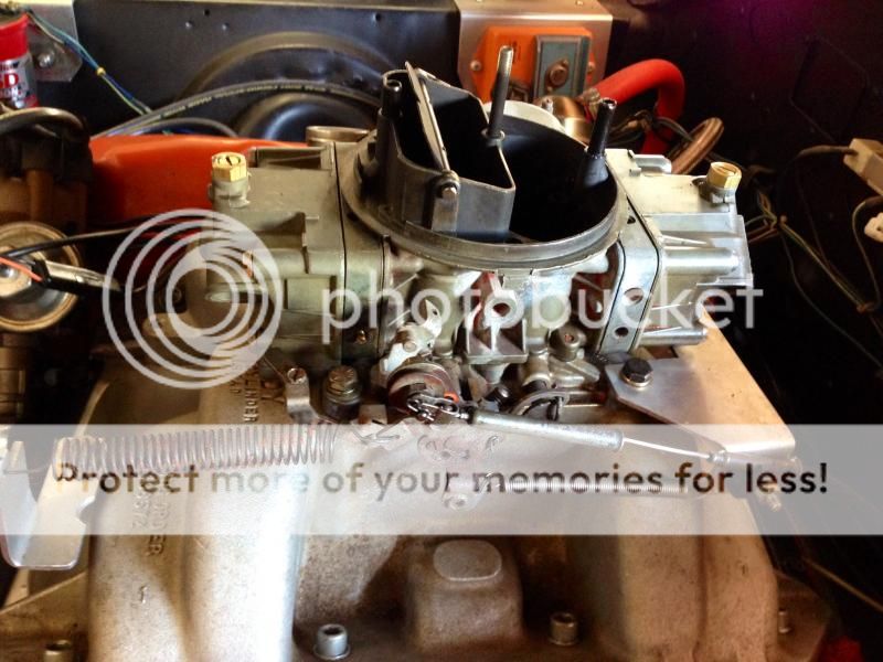

This car is still very new to me and I'm trying to figure out exactly what I have. Can anyone identify this Holley carb? I can't find a part number on it that matches anything I see online. Thanks in advance.

look for some numbers stamped on the choke tower. i'm gonna say 3310-1.
If it's a 3310-1 as lewtot184 says it's probably a 750

OK I'll take a closer look for those numbers. It's a 440 with a hot cam, ported heads and INDY intake manifold. Built for drag racing and tuned for 100 Octane. I need to tune it to run on pump gas.
I am going to guess 3310-2. If it's a 3310-1, does that mean a 780 cfm, due to the thin throttle blades? Stunt, be sure to figure out what your real compression ratio is before going to pump gas. The issue for octane isn't the "tune", it's the compression ratio. If the motor really was built to run 100 octane (high compression 11 to 12:1). An iron head 440 will need to be more like 9.0:1 to run on pump premium. Good luck.
It's either a 3310 or a 3310-1,the 3310-2 and up didn't have the secondary metering block,had metering plate instead.
"It's either a 3310 or a 3310-1,the 3310-2 and up didn't have the secondary metering block,had metering plate instead."
OK, thought the -2's still had the metering block. The 3310 & 3310-1's were a really good piece. I had a -1 on my '70 Barracuda streeter with a DP4B & ran great.

The older 3310's have the down leg boosters while the newer ones have the straight ones. The down leg boosters are the least restrictive thus flowing more CFM.

Ok so it is a 33101. Do you guys think this carb will flow enough to run on pump gas? Any recommendations on a cam to go to. Need it to be very streetable on 93 Octane but that will still provide good performance at lower RPMs. Thanks.

Great guess, Lew. You win the prize, which is in the mail...lol. Lee, the 3310-1 is a 780 CFM vacuum secondary carburetor, one of the best all around street carbs that exist.
the 780 vacuum holleys were extremely versatile. quick fuel makes a 780 vacuum "clone" of the holley version. they have the same venturii and throttle bores of the 800dp holley. i think a little more power can be had by going to a larger carb but i don't think the cost could be justified for the power gain.
