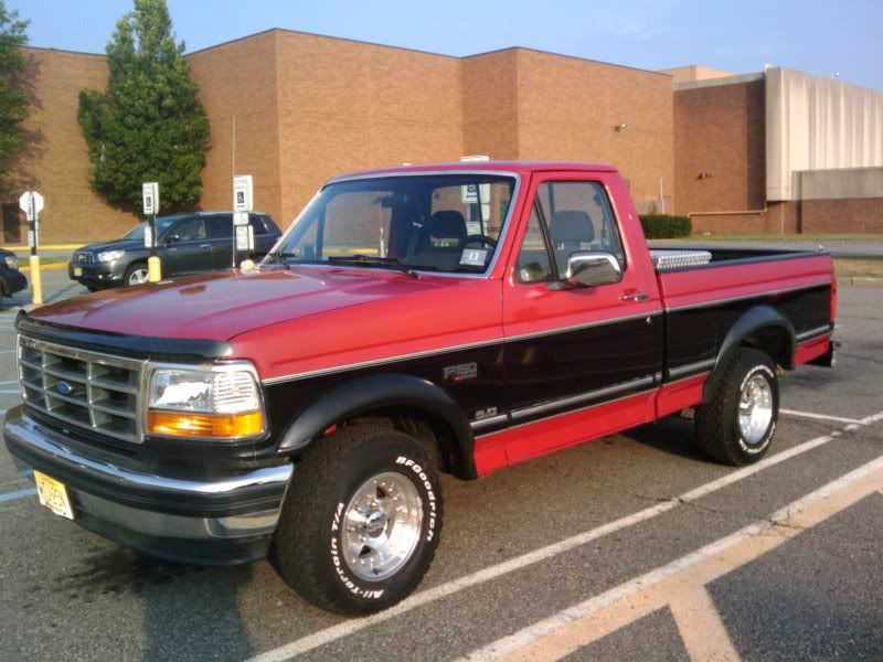

And for kicks and giggles, my daily driver...

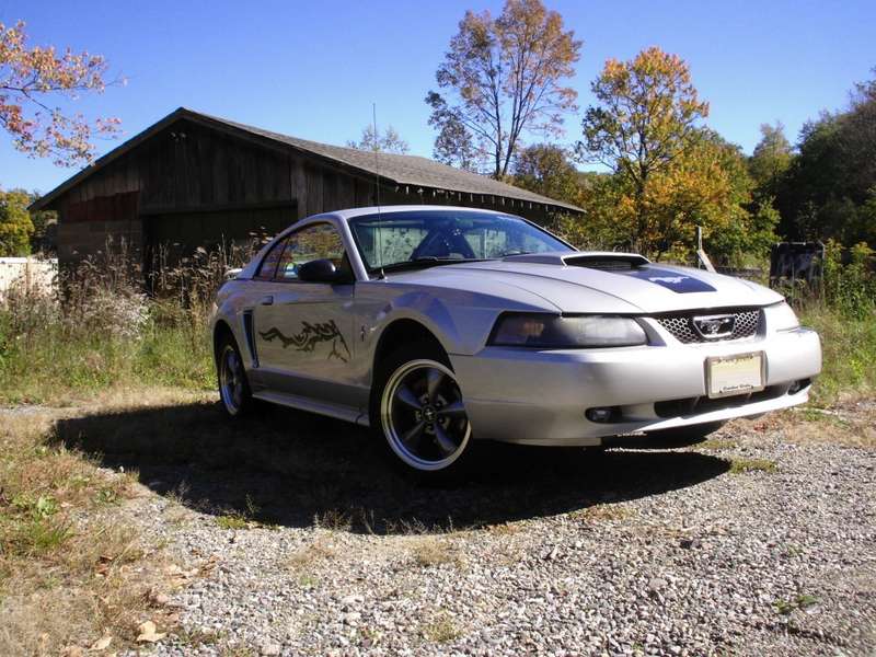

Last show/cruise I went to was last year in Stone Mountain, GA for a big Silver Mustang get together. My "cruise" car has been in quite a few parts as of late, and ever since the local car club the "Jefferson Cruisers", which I was part of, disbanded 2 years ago I haven't really gone to many shows or cruises. Kind of miss it - it's nice to meet other true car buffs and not the local "rev-rev ricer" crew (annoying little _____)
Reason I'm around here as of late is this: http://www.forbbodiesonly.com/moparforum/showthread.php?t=12650
Living so close you may have seen this car - heck I may have zipped by you once.
