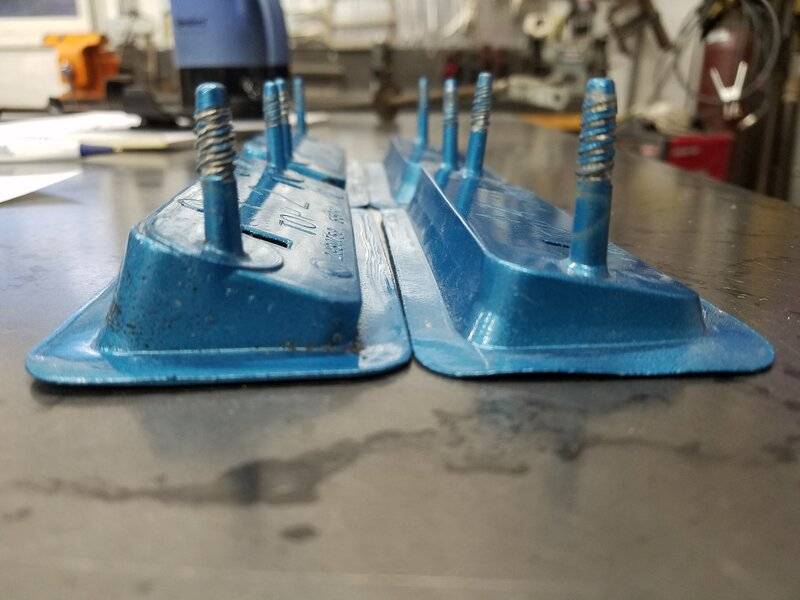

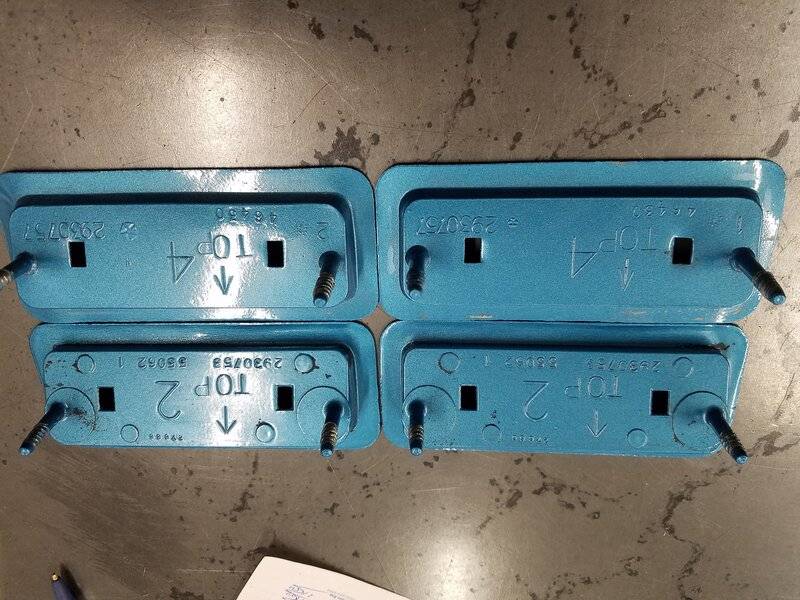

These came off my 69 Road Runner and would like to confirm if they are correct. 2930757 is 1/4" deeper than the 2930753. I see repops are made, but only the shallower version and listed as being the same for front and rear. Anybody know if I have 2 that are wrong and that all 4 should indeed be the same?

Definitely have to be 69 parts as the 70's on the Dusters and Runners and such that looked similar were all lit up and had the center hole for the bulb. Just a question if they are A body variants or B body Plymouth/Dodge housings......I am sure someone who is into P/N's more than me will pipe up soon and have the exact fitment. I think the more important part is that the contour of the housing fits flush to the panel more than the depth of the back as all 4 of them are placed into an open hole letting them sit flush either way correct? I am trying to pull some info from Memory on my 70 Duster as the front fender ones seemed to not sit as flush as the rear quarter housings lens wise. I wonder if it has anything to do with the backing plate that holds them on being deeper or different shape that goes against the quarter panel on the inside vs the front fender?
Hunt.....edit to my original post here's some info on an older post I have attached. he says the fronts are deeper than the rears housing wise. I remember the same on my 70 Duster I believe. Two were deeper than the other two.

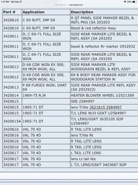

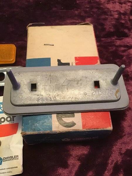

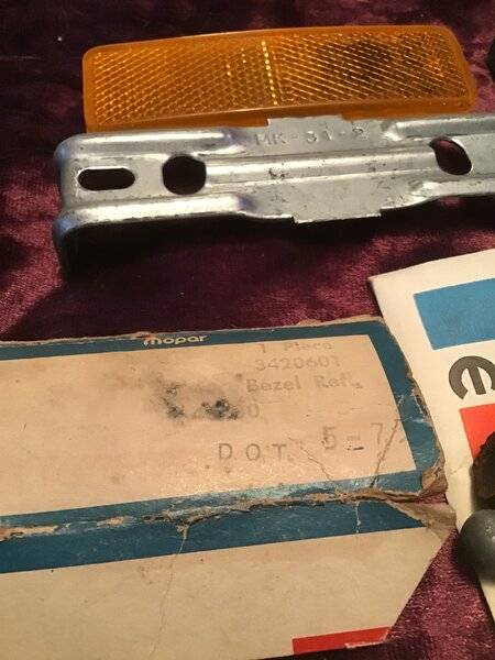

They are correct according to the 69 parts catalog Joel. I have a fender 2930757. The mopar replacement part number is 3420601 and also 2932926. The quarter panel 2930753 is replacement part number 3420608 and also 2932928.
Google search points toward the 757 being the front, and 753 the rear for a 1969 RR. I have seen this difference as well only to find out there are several different bezel housing for different cars.
That is the best answer I have now.
D
What page are you looking at? I could not find it.
Edit: Found it. You need to look for the replacement part numbers not the ones cast in the piece....

Did a little digging for you and Tony's parts lists the 0757 as the front assembly and from another post another forum the 0753 is the rear set.
And there's the answer while I was digging.....good info to know and stash for lata use!

Thanks guys. And here I thought 2 of the 4 were wrong and I would have to find some more. I'll use what I have.
