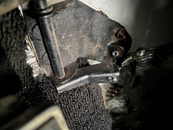

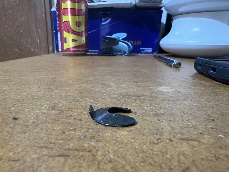

1st pic is of the old clip. I guess it's raised / convex as it is to provide a slight spring(ish) pressure between the cable end and the firewall grommet. Well... now it just slips out. I just got the darn thing a couple months ago. Anyway, I found an e-clip that fit and squooshed just a hair so it's tight. Fits good and stays in place.
And yes… That is my 5 o’clock IPA from Lost Coast Brewing in Eureka. Killer brew. thanks All.
