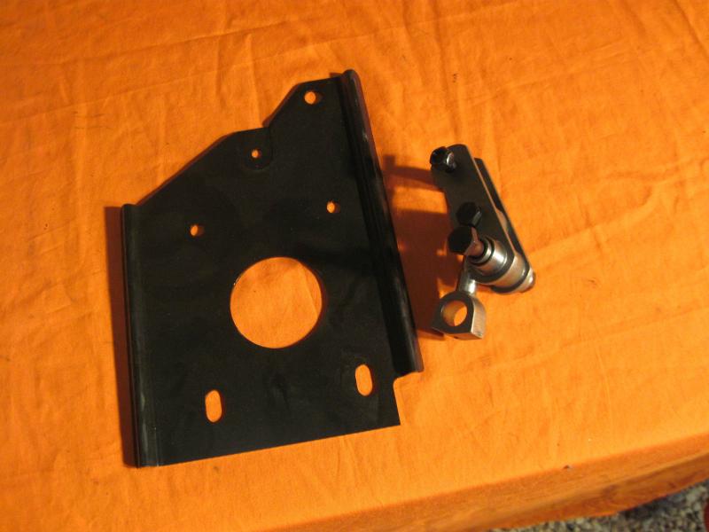

This?
The Ram Man looks a little different.

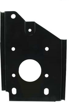

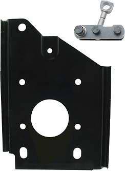

The Booster Plate shown on The Ram Man website has two less holes but otherwise seems pretty close. What exactly doesn't fit on it?
Shawndaniels, do either of these two examples look like what you got?

Yes that is what I'm looking for ....the only year that will work is 68-69-70 I have one for a embody it's to short
