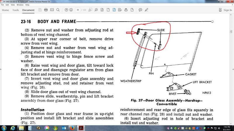

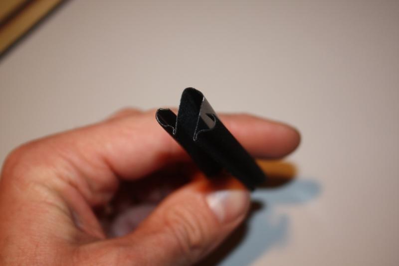

I can't seem to get the new vent wing channel felt to slide into the vent wing channel. It seems to be getting tight about 2-3 inches in at the plastic slider blocks. Is the felt supposed to cover the plastic sliders? Or am I supposed to cut out the felt over the sliders so they poke through the make contact with the channel?
I hate those things with a passion. I'm all ears on this. I have ruined many of them over the years when they get crunched up in the window frame.
If you look at the little white tabs (slides) that snap through the glass, the are a little thicker than the originals. I solved the problem by sanding them down until they slide freely in the frame.
Give that a try, it should do the trick. Yes the felt is supposed to cover the slide. Hope this helps.

I have attached a picture of the ones I used that I ordered directly from Chrysler. Yes, not cheap.
Hope this helps.

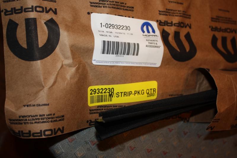

I bought a set of the OEM felts (part# 1-2932230) and installed the driver's side today. It did not go well.
First, it was hard to slide the felt by itself without the window into the channel. Second, it was hard to slide the window with the felt on all the way to the top of the wing frame. Third, the window rolls down a bit harder than it should but it takes waaaay too much effort to raise it.
I must have removed and installed that window now about 7 times. :(
