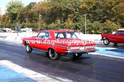

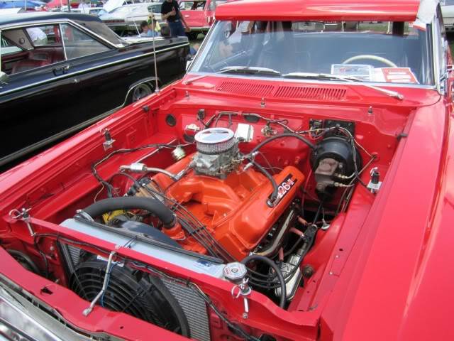

Mine is a 493 in my 63. I use a 440Source kit and I went with dished pistons because I use the Indy EZ heads with the 75 CC chamber. I have good quench and 10.6 comp so it runs fine on 92 pump. I am using the Indy dual plane intake and it along with my heads are Max Wedge port size. It has a custom grind solid flat tappet cam thats 264 & 270 @ .050 and .634 lift with 1.6 rockers. 110 LSA anbd I have it on a 106 ICL. I am using an 850 DP for now and it ran 11.0's @121 but it was bucking in the top of the gears as it was still to lean. I know with it fattened up a tad it should run easy 10's. Thats running it thru the full exh just like I drive it as I drove it to the track. Ron

Only issue I had with 440Source was the wrist pins are a tad tight in the rods but that was fine with me as I like to fit them myself. I used a brake cylinder hone and sized the rods just right. Everything else checked out good and is working fine. Ron

I did mean to tell you I rejetted my carb and ran a best of 10.76 @ 124.49 ! Ron
