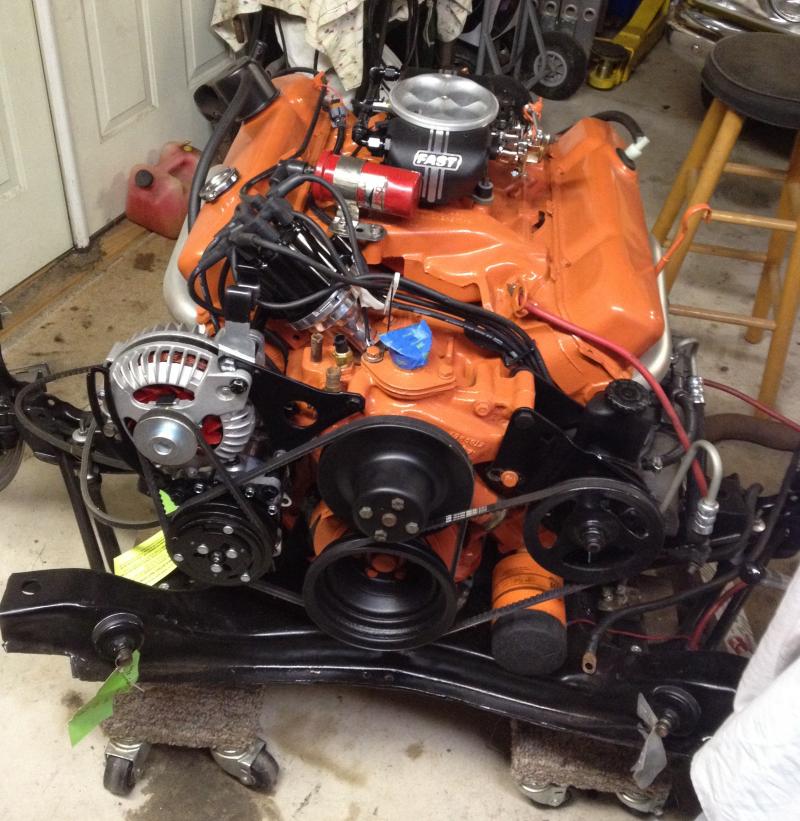

I purchased mine from Bouchillions (Mopar and Hemi only experts)
Sanden
See pics:
PS: yup, that IS a Hemi with AC

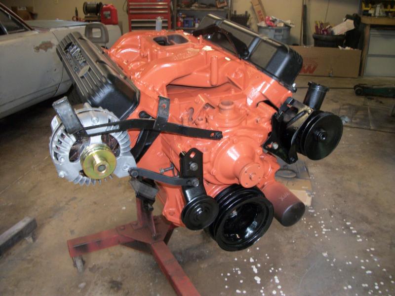

here is a picture of the front of my motor
That's a stock A/C setup with the idler pulley on the water pump belt. Either company can get you brackets and a compressor to clear your air grabber setup.

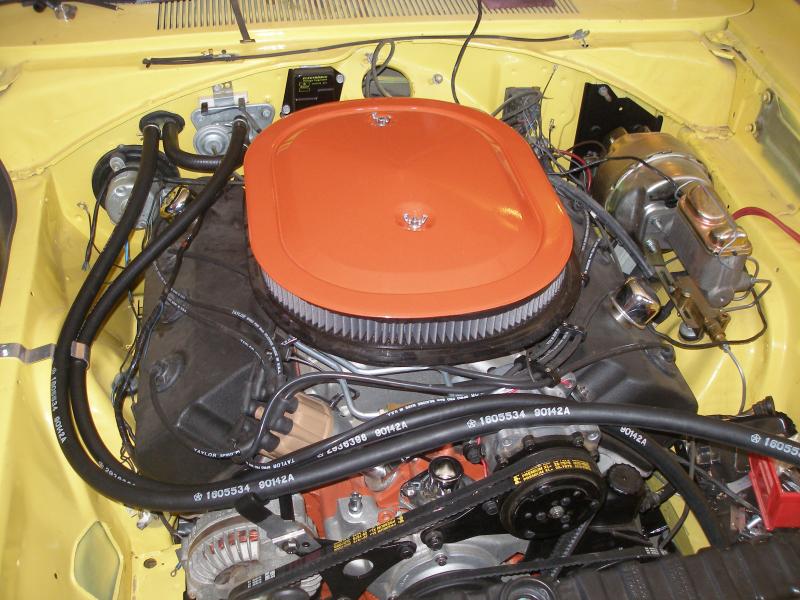

Bouchillon is what you need. Here is a picture and specs - see post #10
http://www.forbbodiesonly.com/moparforum/showthread.php?65096-Hawk-Rod-The-Restoration
Also, here is a picture of my actual engine. IMHO, it's the only way to go, as it keeps the top of the engine pristine and "clean". Note how the compressor is "hidden" under the alternator.

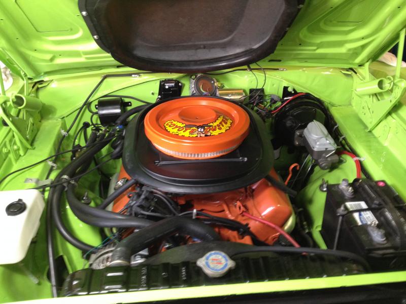

Here is a shot of it installed in the engine compartment. Very little of the AC compressor or plumbing can be seen.
Good luck whatever you decide...
