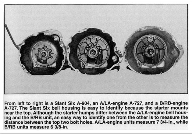

65 is the only year slip yoke push button trans. You can swap the input and pump for 67 and up stuff so you can run modern converters. The shifter will work.
Doug
Hope this helps.
