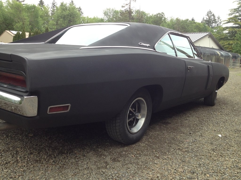

hello, I have a 1970 rt charger. All is stock accept for electric fuel pump. At night when I have my lights on and am at a stop light idling or slow down close to a stop my dash lights start to dim and the idle almost starts to die as if I'm loosing power or the electronic fuel pump is taking to much power and when my lights are on (especially when heater is on or wipers running and lights) it barely has enough power to pump the fuel. As soon as I step on the gas and go, my dash light brighten up to normal power and fuel pump is functions at normal power. Day time with out lights/ heater/ or wipers, it's not that noticable. I Installed a alternator and other parts but it hasn't helped. I thought maybe my electrical want set up right with my electrical fuel pump or maybe something isn't grounded? Any ideas for diagnosis based off of these symptoms? Thank you.
