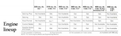

Yes the first two are RP, but I read some where that the plus came with a 360 not a 318. Thank You for the info.
