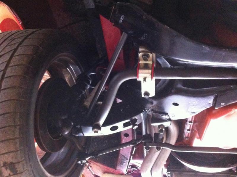

From 2002 until early this year, I had Mopar Performance 1.0 torsion bars in my 70 Charger. Regarding installation, I had 2 choices: I could install them so the adjusters were almost bottomed out with the car still sitting low, OR with the car sitting right and the adjuster bolts sitting below the bottoms of the control arms. Check it out:

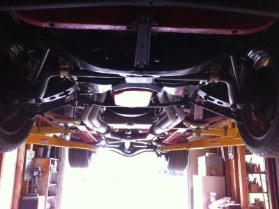

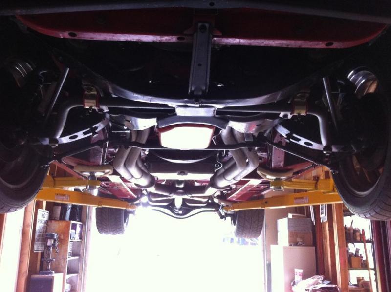

Maybe you can post up some pictures with clear close-ups? Pictures really do help! You might be right at the point of success and some of the helpful eyes here can be what you need.

It's easy to miss something. Since your new at this, and don't feel alone, think you probably need a second pair of eyes on it. Anyone you know that might take a look at it? 'Something' is probably wrong, and that's what's hanging things up. Or, if possible...post some pics, so we can have a peek.

Someone else mentioned throwing some pics up so we can get a visual; it makes a difference. Good luck, let us know how it goes.
