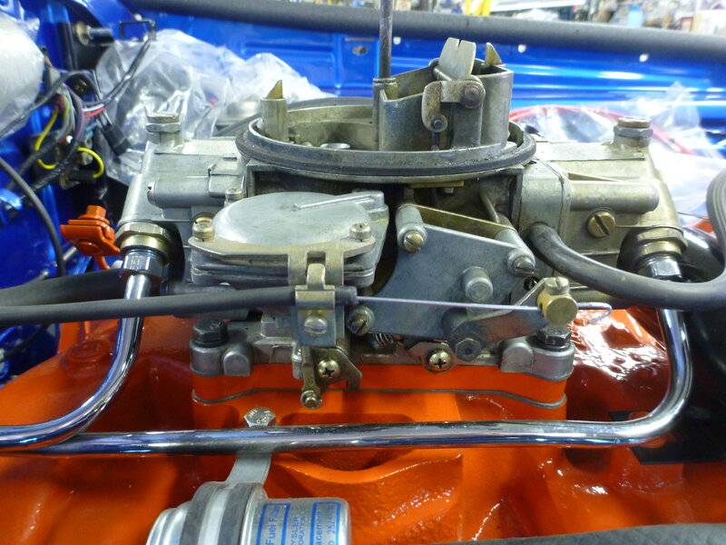

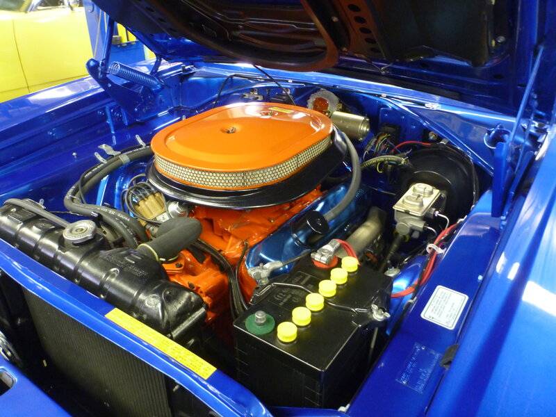

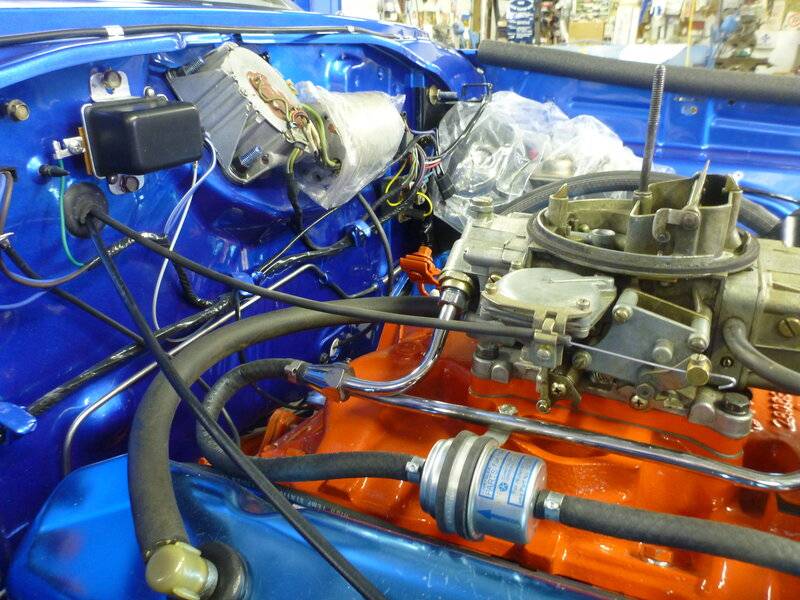

Works fine for me... 750 vacuum secondary, sitting on a 1/2" spacer/adapter.

When I rebuilt the carb during the restoration, I downsized the main jets to 68's from 70's and it runs nice and clean on those..
