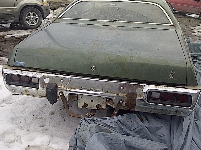

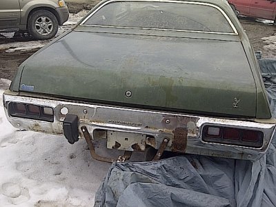

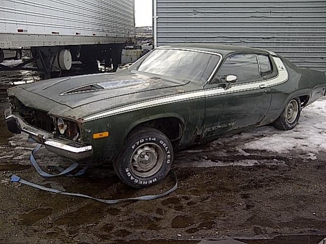

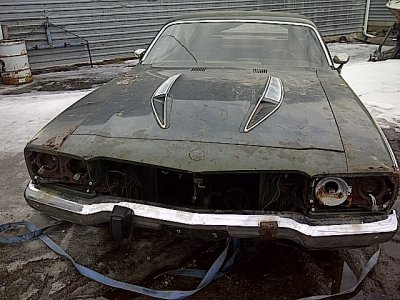

Here are a few shot's of the car. The vin starts RM21 and I am going to get the rest today I hope but I was told it was an original 318 that now will come with a 400

does it come with the grille and headlight bezels and the headlight rings? It looks like a major project to me.
Yeah I need to find out about the missing parts, this is the kicker the guy that has it took the door panels and rear seat out for another project.
Door panels are expensive. I think you will have your hands full with this one. I dont know what you capabilities are but it looks like a major job to me.

I agree with everyone's assessments of this car. You've got rust through in front of the rear wheel well, and I would bet you'll find it throughout the quarters. There's rust/damage to both fenders, the upper valance (which means the lower valance is also probably toast), the door, the quarters, and the bumpers are roached pretty bad too. It also looks like a bench seat car with a green interior, which also impacts value as bucket/console cars are more desirable than bench/column cars, and unless you're going to keep the green exterior a green interior doesn't go well with any color besides green or white.
This car is definitely restorable, but it's going to be a very expensive process, and for what these cars are selling for these days I would suggest finding one with buckets/console that's in restored, or at least better, condition and buying it. This car does have a lot of good parts on it if you can get the guy to part it out. Those mirrors and the trim strip over the rear bumper are often missing from these cars.
I would sure like to know what happened to those bumpers though. That rust through where the missing bumperettes were is pretty unusual. Normally you see some discoloration or variance in shininess where a bumperette was removed, but I've never seen anything like that before.
Yeah you guys are right I am going to pass on this one I just liked the notion of trading instead of buying. Like I said I went through hell trying to find good parts for my 66 Charger and this would be the same.

Best of luck finding your dream car. I agree that you can do better than this particular example. It's a little to gone to consider it for much more than parts.
