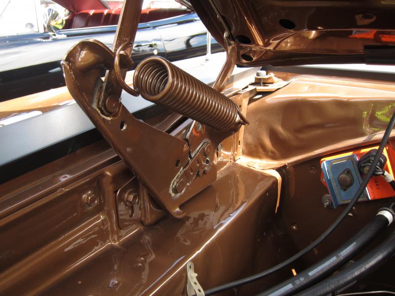

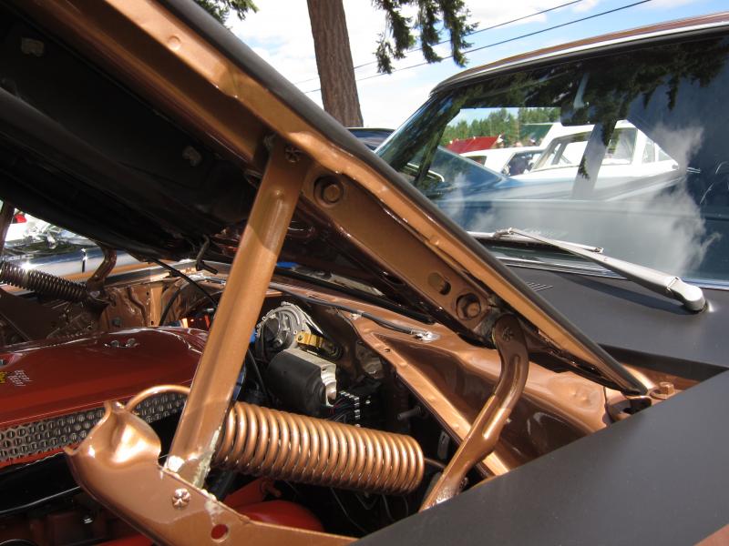

Hinge Pics
do these views get you what you're looking for?
Thank you, Newbaufish! Believe it or not, the 2nd photo with the spring mount waaaay in the back showed me what I needed to know and suspected.

Thanks. Had that but it still kept moving. The problem that I suspected and which was validated was that the PO who put the car together didn't put the 3 bolt in the spring hinge mounts. Hence, the entire assy was flexing around and hence, the hood was moving with it.
