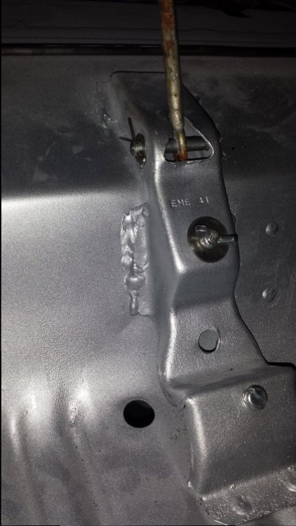

Anyone have a picture of how the jack is mounted to the bracket? Every pic has the stupid tire over it.

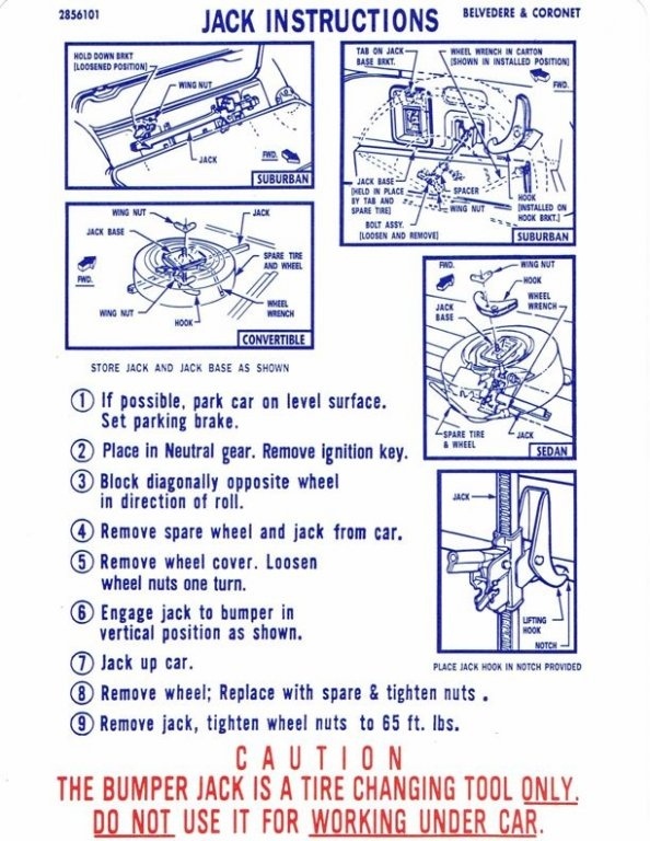

Just put the jack down first, then the spare over the threaded mount inside of wheel facing up, next goes the jack base plate, then the jack hook, then the wing nut. There's an exploded view picture on the jack instructions.
I have the sticker in my trunk, detail is a bit lacking for how the jack is mounted to the floor. There is a threaded hole and a plain hole for a mounting tab of some kind on the welded in mount. That is what I would like to see.
Correct, it is lacking the key detail you searching for. See below...

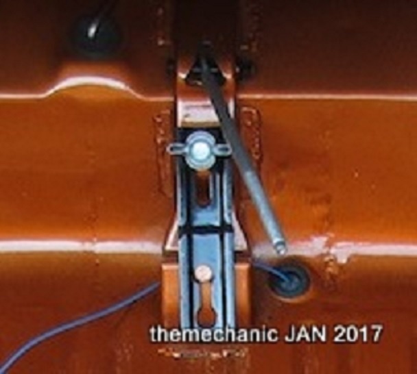

One end slides over the tab on the bracket and the other end is tightened with the screw....

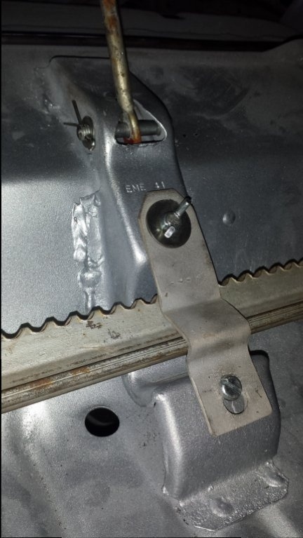

It was broken off. This is my interpretation of how it mounts, cheap b@stard style which I just rigged up. Should work.
