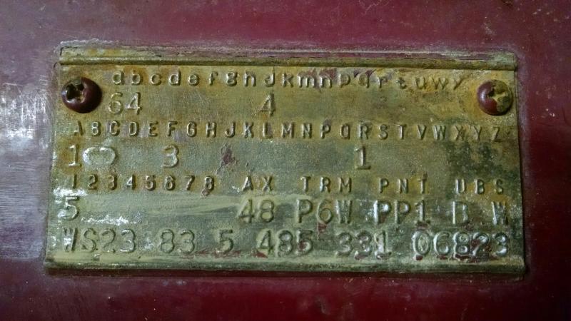

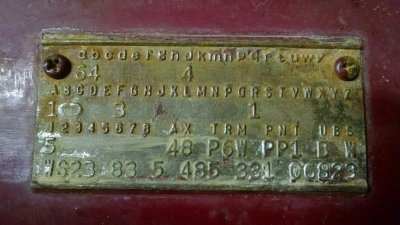

Neighbor has a 67 Coronet R/T he acquired, fender tag says red outside, white interior, and white horizontal stripe....
I'm not sure where the factory stripe goes...who can show me?
Thanks, Bryan
that's not what the fender tag says....under the "B" in the "USB" section it has a "W", which stands for "horizontal accent stripe - white"
Actually, it's under the "S", but for some reason I cannot edit my post
