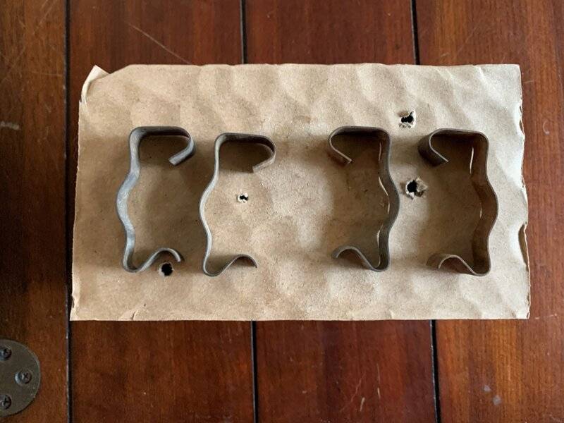

Geff here is what the clips look like. I may have an extra set but would need to look. Hope this helps.

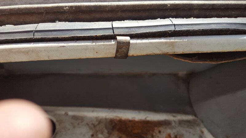

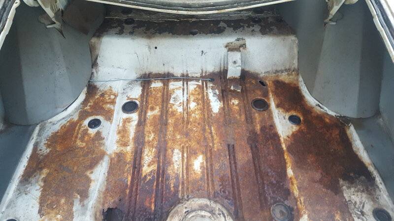

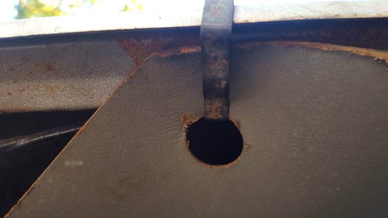

Thanks! Is your cardboard panel pushed fully against the side of the trunk outer wall? I can't figure out the configuration, but seeing your photo, I think I understand better. Do the clips actually fit through the slots in the panel? Or do the clips hold it up and in by friction? Hope you have another set, as I can't find any anyplace.
The pics above show the clip fully seated, then pulled down with the cardboard.
So to install, reverse the pics.

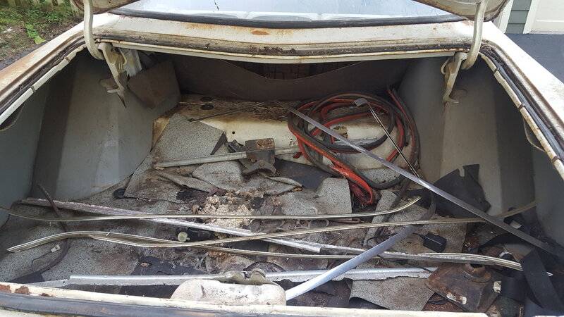

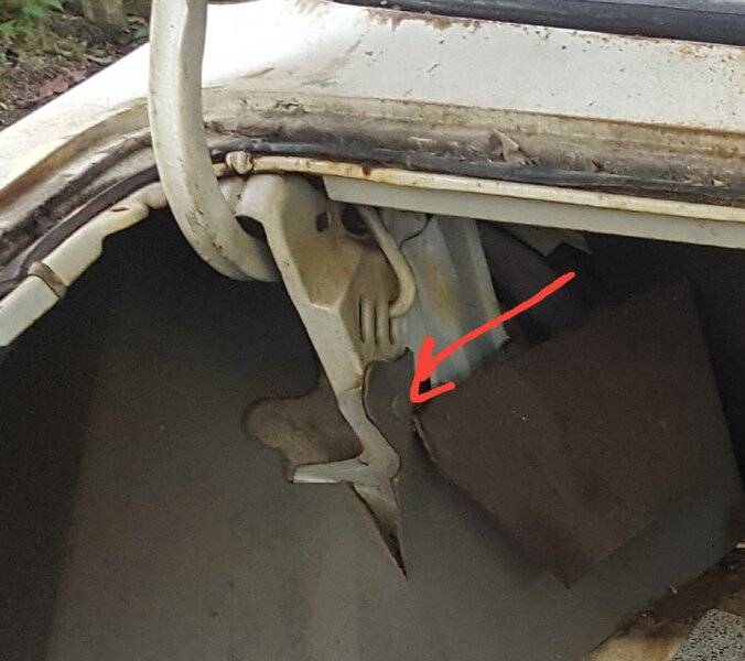

Here's the car when I got it. You can see the round metal grey push pins on the hinge brackets.
Iirc, there are 5 pieces, the seatback, both sides, and 2 trunk extension pieces that sit level with the trunk floor and have pockets underneath.

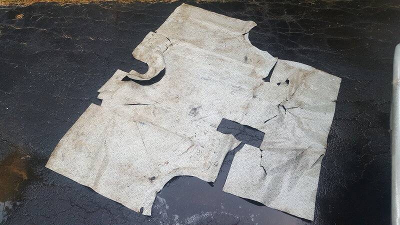

Since we're talking trunks, the trunk mat. I even found all the cutout pieces in the trunk. One was still attached, you can see the L shape cutout on one side, on the other side it's punched but still attached.
Push pin.
Grey painted heads in the trunk, red for the interior rear window.
