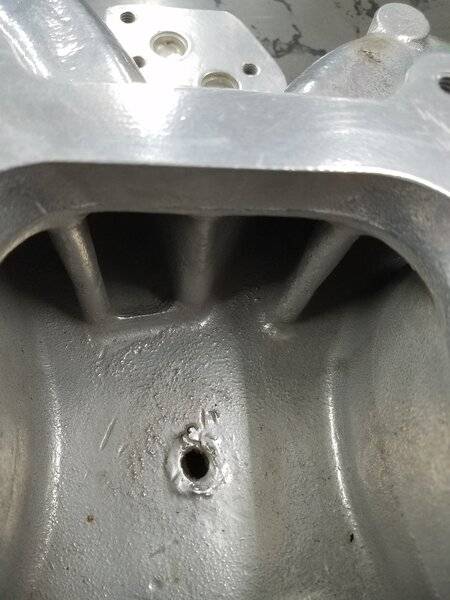

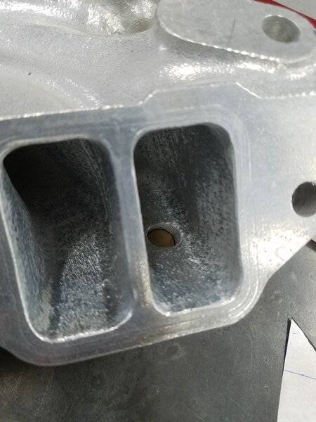

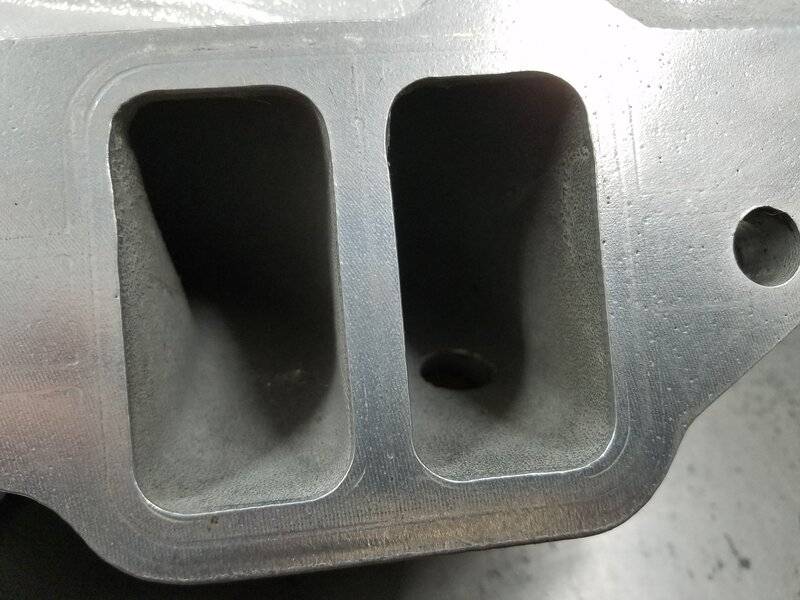

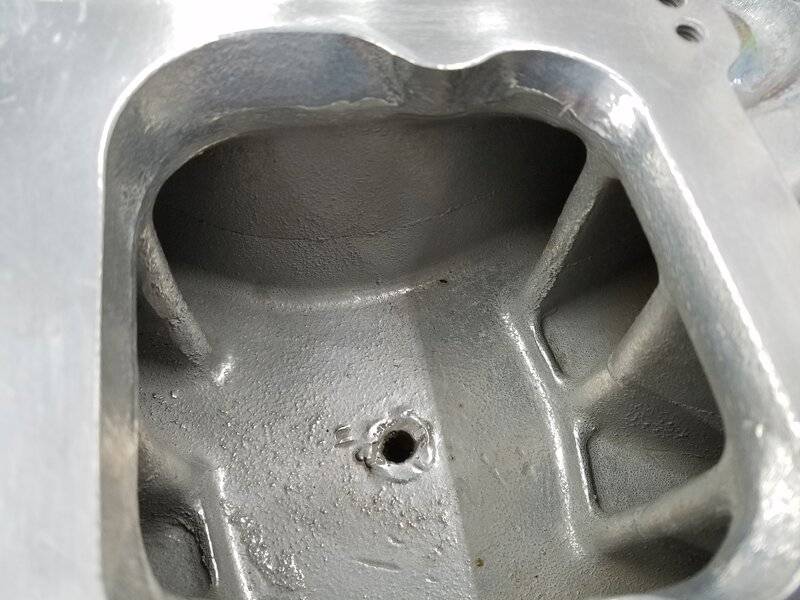

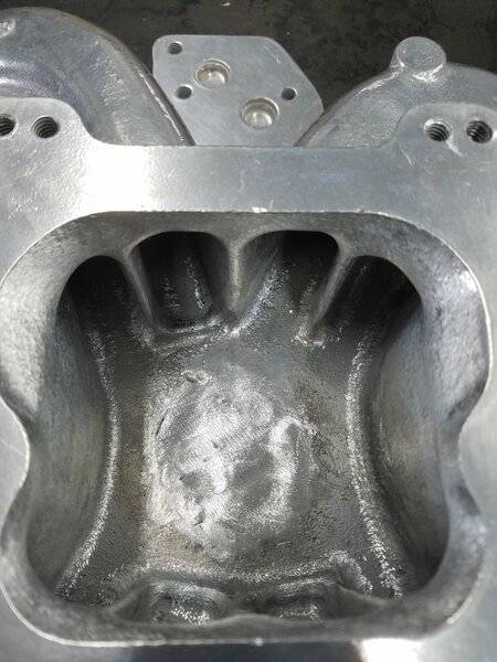

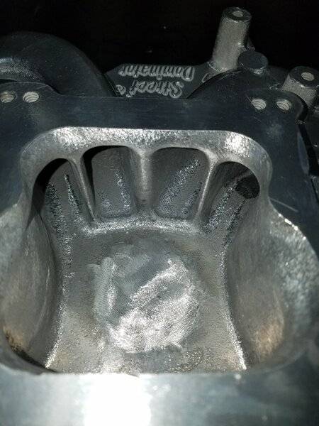

Got the Street Dominator back from porting. Here are some before and after pics. He also welded up the EGR hole in the bottom of the plenum. I installed it and am going to drive it this spring to see what difference it really makes. He is claiming 50 hp more than the Weiand that was on the motor. I can't see that happening, but will never know without a dyno run.

It’s been many years since I looked into the plenum of a low deck Holley SD........ but I don’t remember it having the “dams” on those 3 runners.
I wonder if they all/always had that?
Yeah, I questioned that as well. And why only on 3? He said that is how they were made and he always leaves those dams intact.
