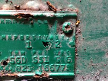

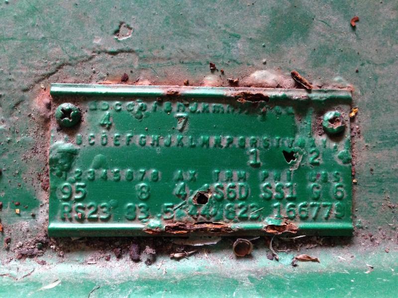

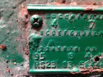

Here's what I was able to get for pictures. Whats the deal with that "4" stamped through the tag?photo.jpgimage.jpgimage2.jpg

Here's what I was able to get for pictures. Whats the deal with that "4" stamped through the tag?View attachment 188147View attachment 188148View attachment 188149
The punch hole is an inspectors stamp if I am not mistaken.
