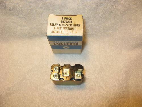

2. Horn relay.

The horn relay original part number is 3579204, shared that number with several other Mopars models over several years, reproductions and NOS replacements are sold on E-bay. The relay is combined with the key warning buzzer.
