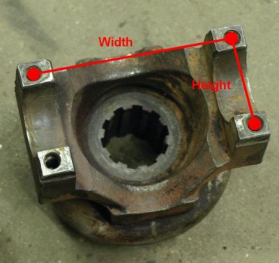

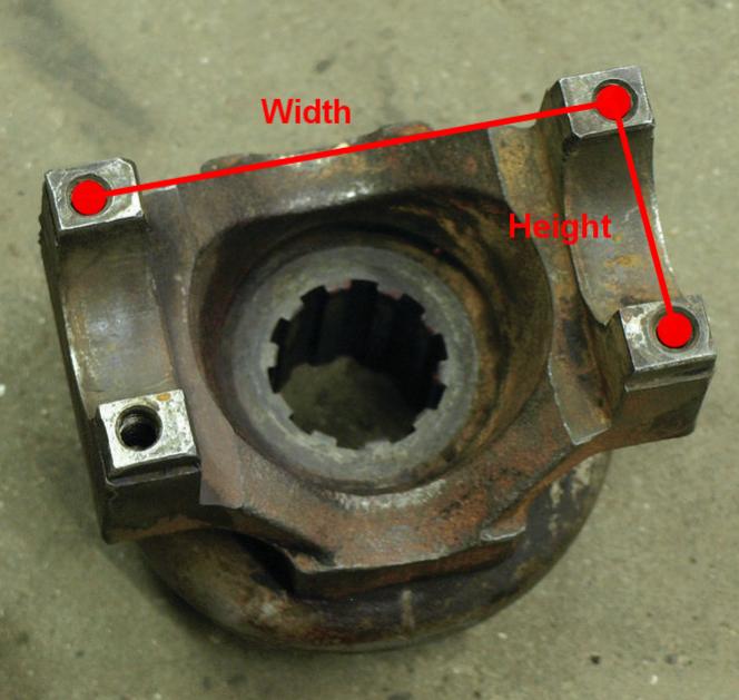

I have a 7290 yoke and need to know the c-c bolt spacing, width and height. I believe the height it about 1.6" but some say 1.5". I'm not sure how far apart they are though...

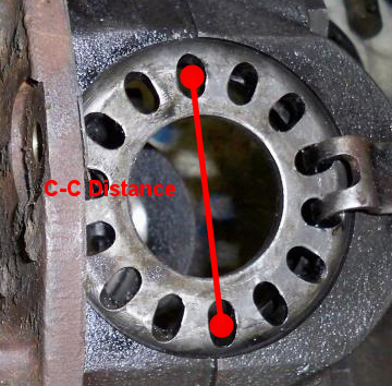

Also, I need to know the c-c distance of the carrier side adjuster holes, from one side to the opposite side...
If anyone needs this info, these are the measurements, to the best of my ability, with calipers...
Yoke Bolts
W = 3.3125"
H = 1.55"
Carrier Adjuster Holes
C-C = 2.625"

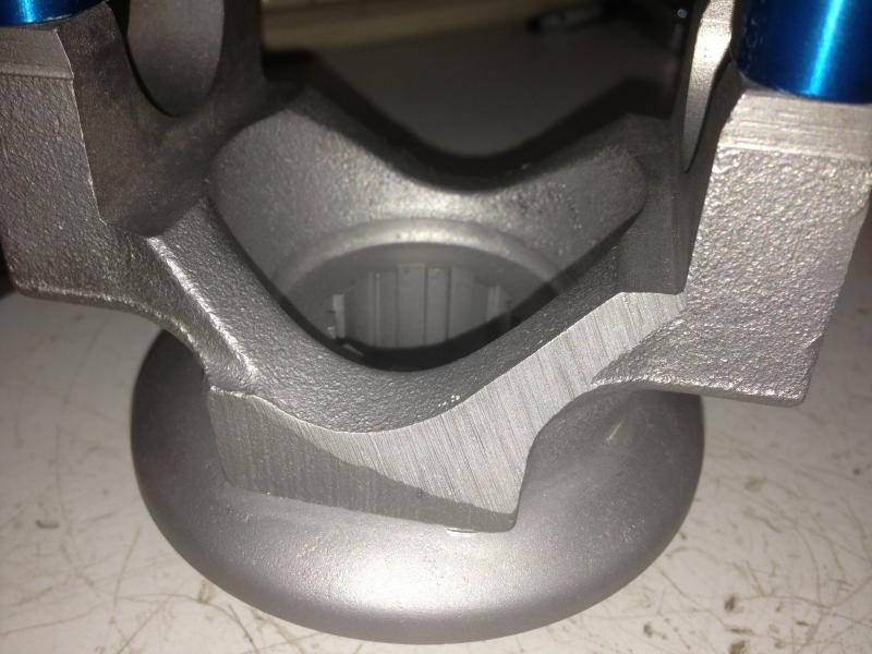

Any idea why my original yoke would look like this?
It's the original that has been on the car, untouched, since new... I sand blasted it and was going to clean it up to use once I rebuild the diff. I have another one, but I'm just confused...
That's where the excess was ground off after it was forged....I like to smooth up the edges a little if I'm going to abuse it.
