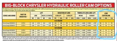

Id like to get a copy of a cam card if anyone has it. or at least the intake and exhaust centerline. I have all the rest of the cam data. including the LSA. need to verify the information I have. The blue in the Picture is an example of the information I am looking for
Thanks,

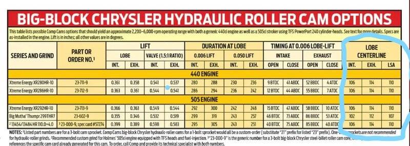

The XR286R is a solid roller...... this data is for hydraulic rollers:
Aside from that...... what do you think the area circled in blue is telling you?

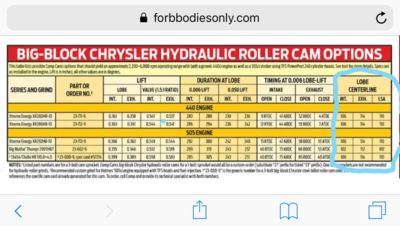

You say you have the timing events.
If you have those...... then you also have the centerlines.
As posted above-
The intake event is 37/69:
So, 37 + 180 + 69 = 286
286/2 = 143
143 - 37 = 106 ICL
The exhaust event is 80/32:
80 + 180 + 32 = 292
292/2 = 146
146 - 32 = 114 ECL
As posted above-
286/2 = 143
143 - 37 = 106 ICL
80 + 180 + 32 = 292
292/2 = 146
146 - 32 = 114 ECL
