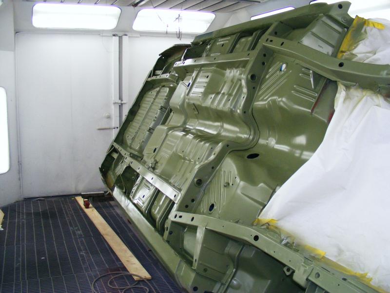

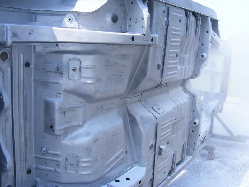

If the car is soda blasted, you have to wash the car with soap & water and "Phosforize" it. If it is blasted with any other media, Epoxy primer can go on right away.
What I mean by "right away", is within eight hours. The epoxy primer saves alot of work and time, but it has to be done right away. You can epoxy prime right over
the old filler as long as it's sound with no cracks or bubbles. after the epoxy dries, you can wet the car down as much as you want to get rid of any dust and work
on each spot that has body filler independantly. Water won't penetrate epoxy with an activator. I suggest DuPont 2580CR Chromate LF Epoxy DTM (Direct To Metal) DSCF8574.jpgDSCF8610.jpg
