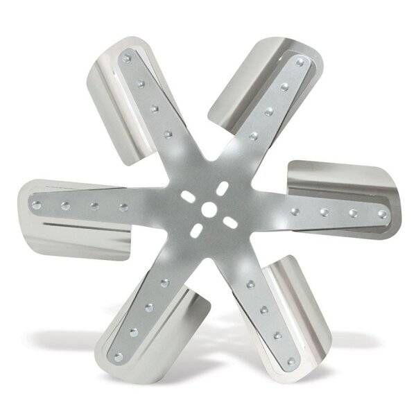

But a new rebuild will run hotter for a while.

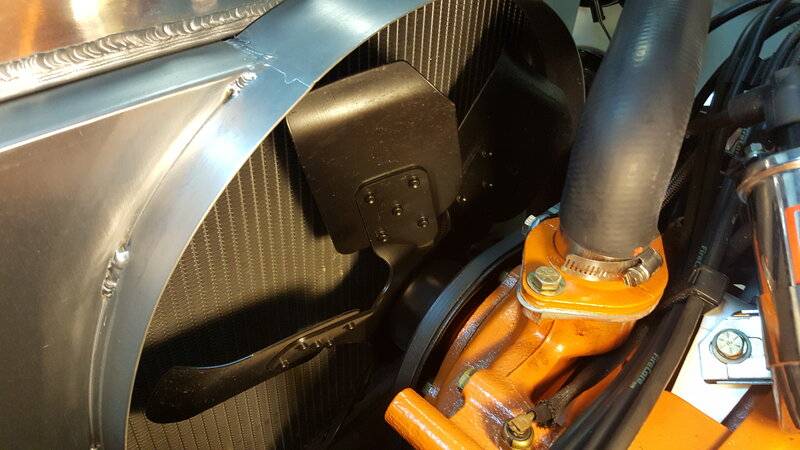

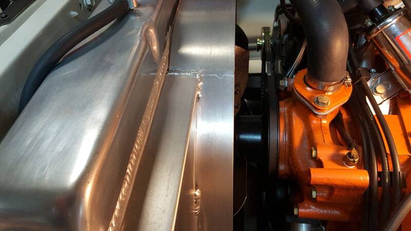

You can see how much I have out of the shroud.

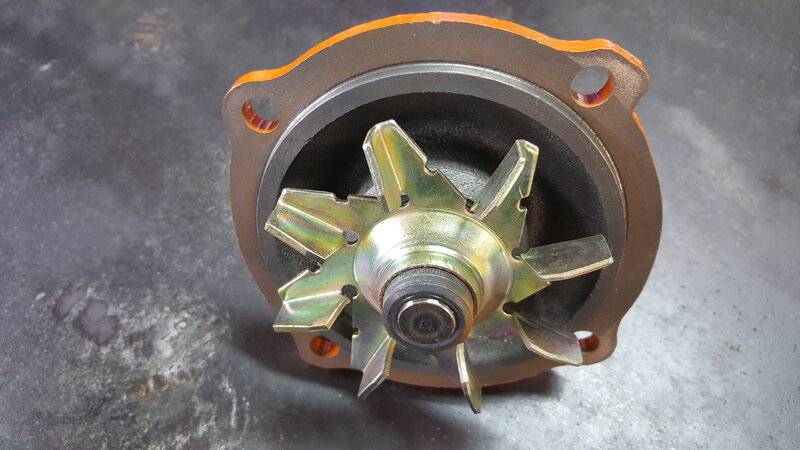

Stock 8 blade water pump.

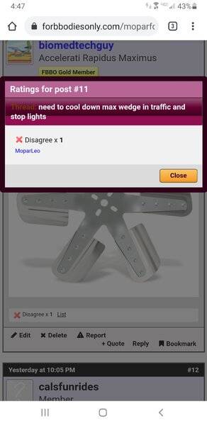

Hey @MoparLeo what's with the unexplained red X?

Not to intrude but flex fans have a reputation of cracking and the the blade flies off putting a nice hole in your hood, radiator and hoses.

Once sgain, I'm conducting classes in the fundamentals of Thermodynamics to disprove the comments regarding flow rates and velocities. BTW....re the B/RB block A/C cars having different water pump impellers....yes they do but are turning at significantly higher RPMs due to the water pump to crankshaft sheave ratio, moving the coolant faster (velocity) and at higher flow rates (gallons/minute). In addition, just ask the Evans Coolant boys which coolant is best....
