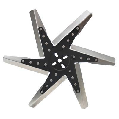

Maybe varying degrees of build quality and materials? I seem to remember some pretty flimsy ones to the touch from "back in the day" but I find it hard to believe that Derale would make a fan that would come apart.
FWIW here's what mine (I needed a thin one) on the Roadrunner looks like:

Not to intrude but flex fans have a reputation of cracking and the the blade flies off putting a nice hole in your hood, radiator and hoses.
Not sure what the infatuation with flex fans is....both the aluminum or fiberglass blade design... is it strictly cost? They are significantly cheaper than the "tried and true" rigid design with either a torque drive or thermal drive clutch arrangement.....BUT...nothing is said about performance in terms of air movement (CFMs at some RPM level)....only "works great" or ???....nothing quantitative only a subjective thought..... how can effective performance, in terms of air flow at some RPM level, be compared to a "feeling" .....perhaps measuring effectiveness in terms of a drop in coolant temperatures at a repeatable condition (air temp entering the radiator) at a given speed to compare either the flex blade design (with and without a shroud) and a rigid blade design with clutch arrangement (with and without a shroud). Comments without some form of substantiation are only just an opinions....and we all know about opinions..... The other factor is flex fans have been known to fail unexpectedly....often catastrophically. I'm sure others will disagree.... Just my opinion of course.
