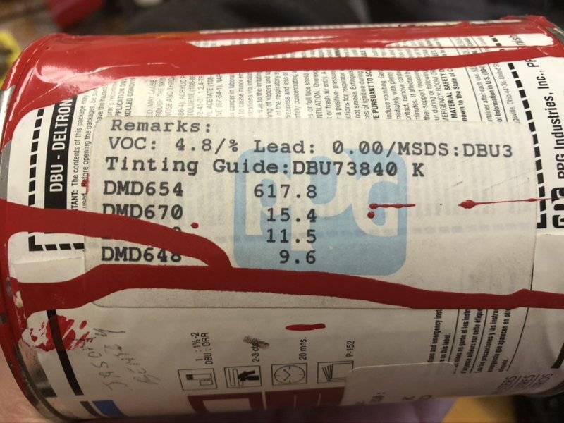

The car was sprayed with Deltron DBU. I have no idea how old this paint is, but I'm guessing 15+ years old. I'd guess there's about 1 cup of color left. I also see that DBU is no longer made, so what would you all recommend as an alternative?
