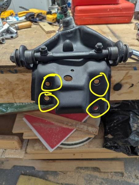

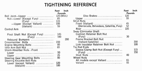

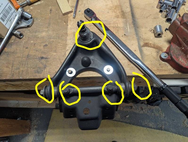

Unable to find the torque specifications for the front end suspension.
The information I had got lost.
Upper ball joint
Lower ball joint
All the bolts on the upper arm, pivot shaft, and mounting plate.
Thank you kindly
Not sure about the others but your Castle nuts go 60ish and get the slots lined up for the cotter pin. Don't back the nut off to align, tighten more.
