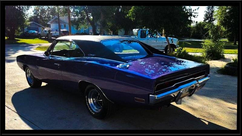

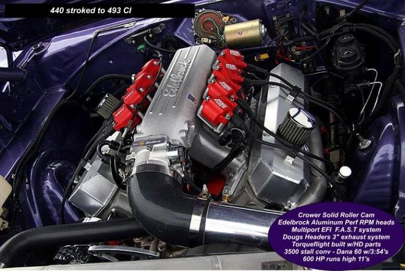

Hi guys, need ur skilled help to suggest tires for better traction. Im not opposed to drag/radials never rain driven anyway. Currently have 265/65 BFG's. I dont want to go taller but definetly need something that will hook up. 580HP 3:54 Dana 60. Im 70 yrs young and dont abuse my car but every once in awhile, the kid comes out in me. Thanks in advance for your help
