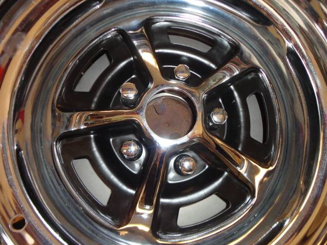

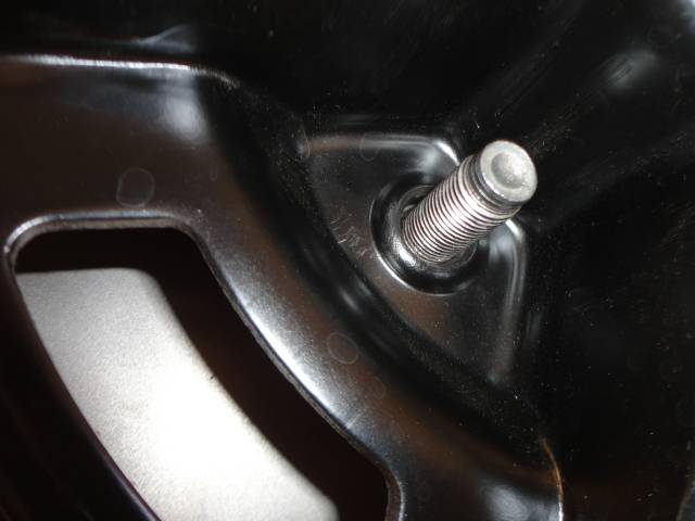

I was mocking up the rear wheels on my 70 GTX after brake install and noticed that there was not very much thread length for wheel inst. It appears that there is only 7/16" of threads sticking through the wheels for the nuts. I'm thinking that's not enough even if this is stock 440, auto, with 8 3/4. Here's what it looks like on the car.

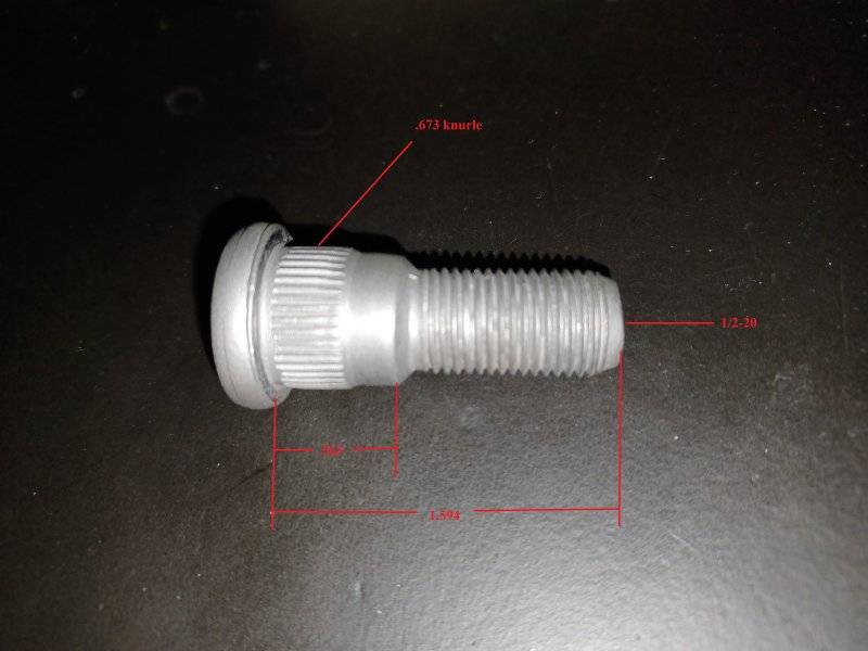

I looked up the wheel stud on RA and measured what was on the car and they matched. The factory stud measures 1.594 for under the head length, and I think 2.0 would be better. The problem is I can't find anything close to that length with the correct knurl size.. Somebody has to have long studs for an 8 3/4 especially if they race.

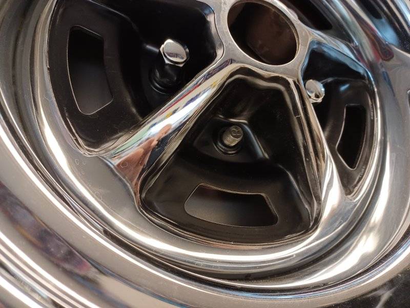

Well I got my new studs in thanks to Beanhead. Makes me feel safer with at least 1" of threads sticking through the wheel.
