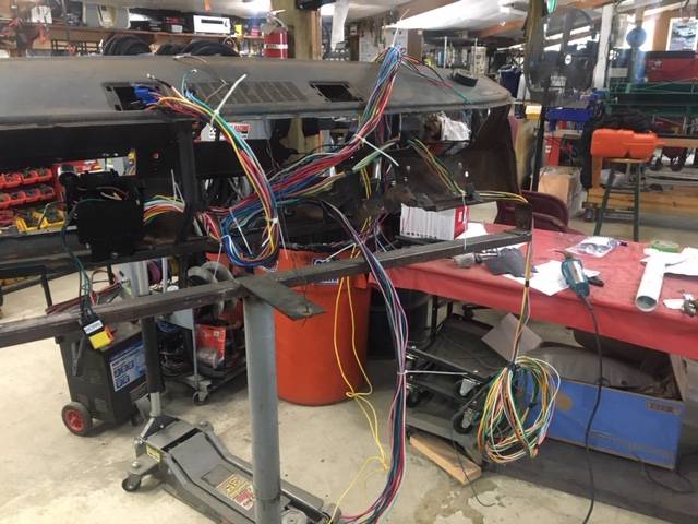

9. lay out your harness at the beginning. I am not sure if you have the dash out but I HIGHLY recommend it as it makes it so much easier to deal with.

9. I am not sure if you have the dash out but I HIGHLY recommend it as it makes it so much easier to deal with.
If practical this is very true. It sucks trying to fish an entire harness through the dash while it's in the car. Lots of sharp edges, you're generally upside down and it's hard to see what you are doing.

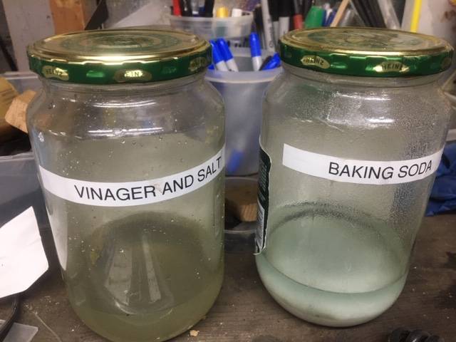

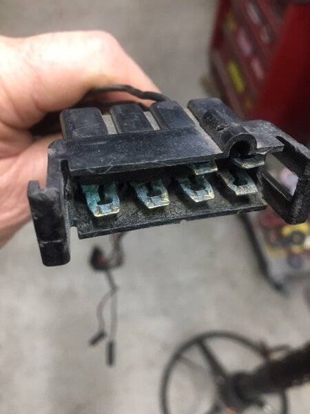

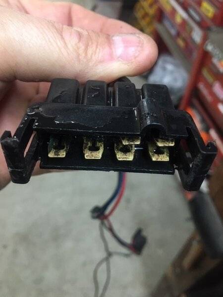

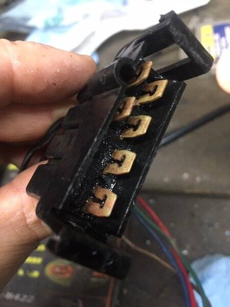

I am not sure what original things you will be using but here is another tip. If you have corroded electrical components/terminals here is an easy way to help deal with it;
- get a jar and pour in some white vinegar along with a generous amount of salt
- get a second jar and pour in some water and baking soda
you use the vinegar/salt to eat the corrosion, if possible you can submerge the corroded part in there (just the electrical terminals) for anywhere from 30 seconds to several minutes. Then you rinse the part with the water/baking soda.
The 3rd pic is after being submerged for about 30 seconds (swishing it around) and the last pic is after about 5 minutes.
