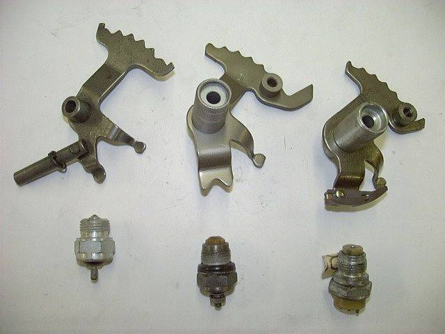

You would of had a single pin switch.
'67 Factory service manual still calls for a single post neutral safety switch. I think '69 was the changeover year to three prong for the back-up lights. HTH, Lefty71

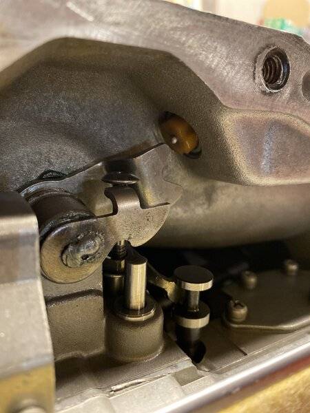

Because the transmission is 50+ years old and might have been modified, check the rooster comb to see which switch to use.

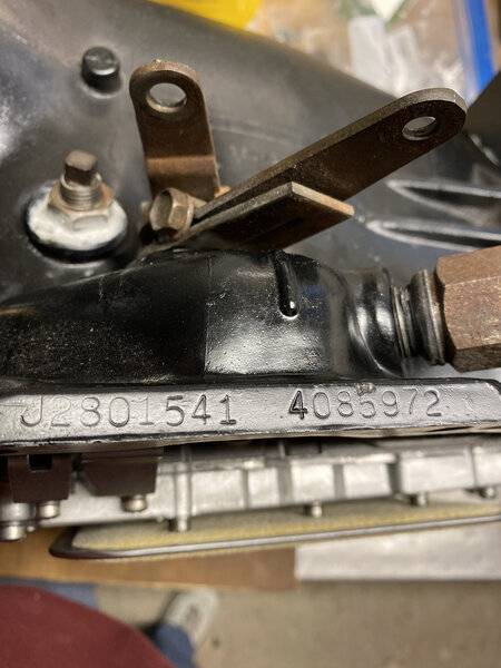

You should post the numbers on the drivers side trans pan rail to find out what year the trans is. As in post #5 the rooster comb dictates which NS you need.
I have the middle rooster comb, case is a 67 vintage. Fran if you have the switch I need tell me how much you need. My shipping address is
