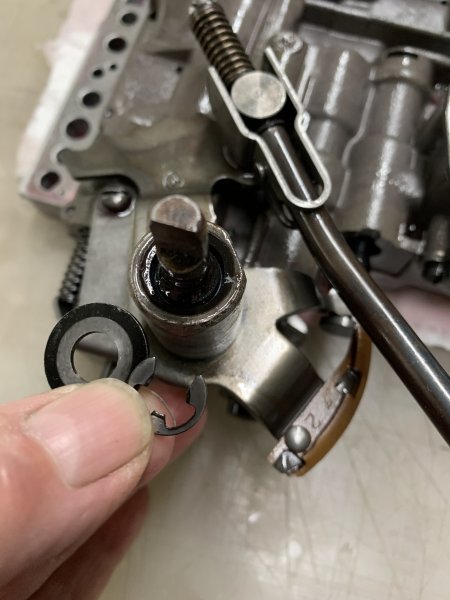

#1 is the only picture I have of the rooster comb that is in the trans. It is what was in it when I got the car. The trans already had a shift kit in it but I bought one anyway and went through the whole installation procedure just to make sure as this is the first auto trans I have ever rebuilt. I am proud to say that it does work perfectly and that when I drained a gallon + of fluid out of it to change the switch I found not a spec of material stuck to the drain plug magnet which was a major relief.
I understand the picture is not the greatest but can someone tell me if in fact this is the correct rooster comb for this trans. Everything on this car has been messed with by backyard Bubba so who the hell knows what is right or wrong. The last two plus years have been a real education and a full blown exercise in "classic car mission creep!".

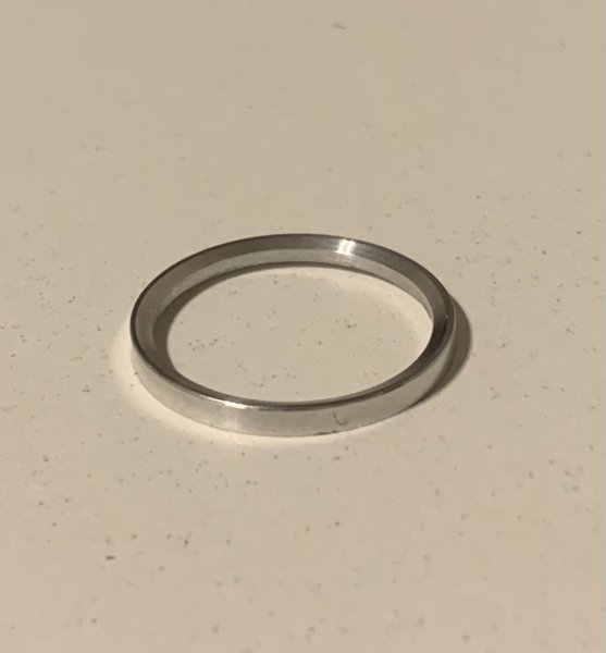

#2 is a spacer I made to move the switch away from the plastic shoe by effectively "shortening" the distance the switch goes into the trans body. I tapered both sides of the spacer 25 degrees and put a o-ring on the side that contacts the trans housing and left the original washer/seal on the other side in its proper place. The spacer ended up being about 0.110" thick and with it I now have backup lights and a properly operating NSS.

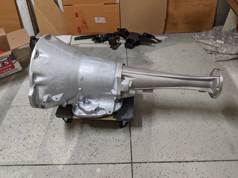

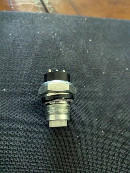

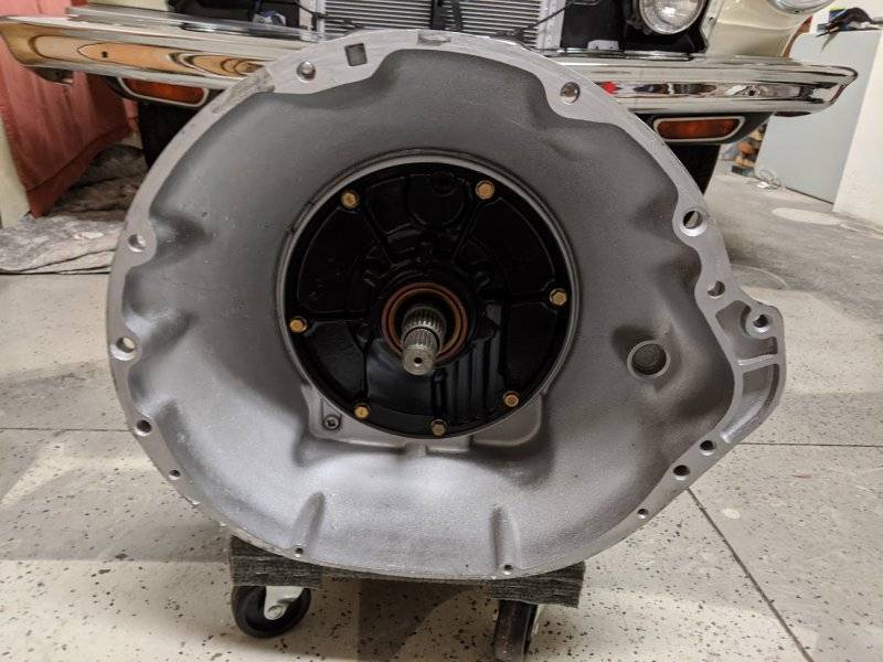

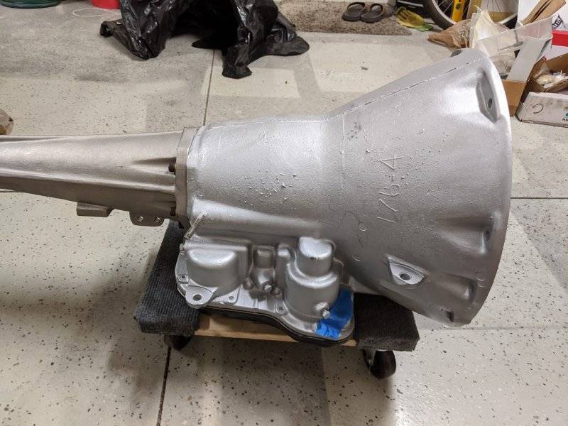

Not wanting to hijack this thread but this sounds suspiciously like the issue I am having. I have a rebuilt transmission in my car. (big block 727). Not sure of the year as I cannot make out any numbers on it. A while back I had sourced a NSS and threaded it into the transmission by hand. I continuity tested the pigtail wires and it worked. I am now finalizing the wiring. I had reinserted the NSS and tightened it up. Neither the NS or back up light function of the switch works. With the car in park, I see the contact on the rooster comb and tested that . It grounds correctly. There is continuity within the switch. In reading this thread I think I had initially not threaded the switch all the way in and got lucky with the test. With it tightened up, it no longer works. Did anyone ever find a source for the shorter switch?
