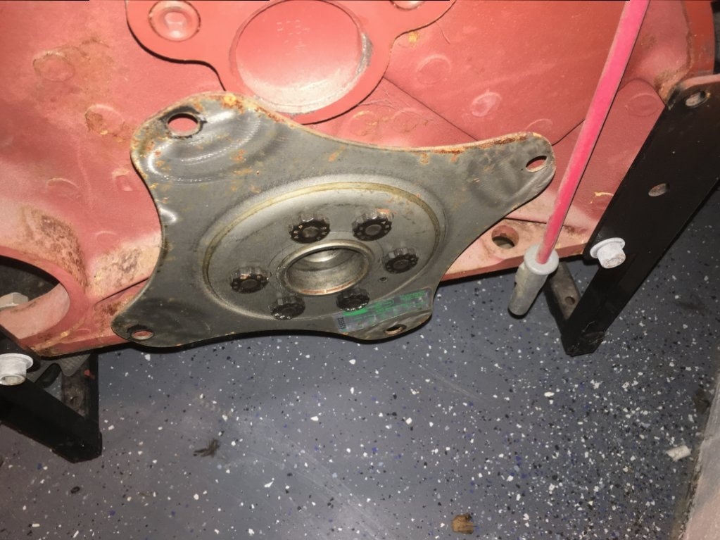

So correct me if I'm wrong but this looks to be internally balanced? I don't see any weights?
I've never heard of a flex plate having weights. I can't tell if the balancer is externally balanced or not from this pic. The balancer for cast cranks I've seen look wider than the one in your pic.
I seen a few that had weights on them online. The rest seemed to have a portion removed from the flex plate. Think I should pop it off and get a good picture of the front and back?

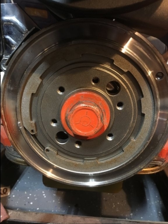

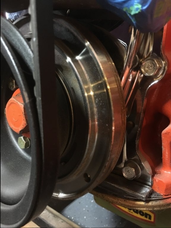

Edit: pulled the pulley off and took this i don't know if that helps I didnt feel like taking it off tonight... couldn't find the right tools . But there isn't anything on the back that stands out. its symmetrical from what I can see and feel. There was a couple numbers stamped on the side but came up empty on Google. SFI SPEC 18.1 A299355.
