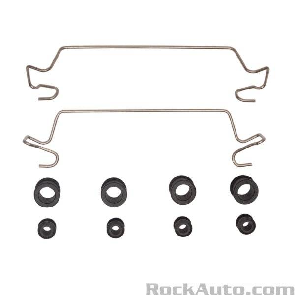

Just buy the pin kit on rockauto.com. Comes with 4 inner rubber bushing, 4 outer rubber bushing , called disc brake hardware kit (1970 Cuda)
The rubber bushings push into the caliper , 2 large inner and 2 small outer pr caliper. Make sure to grease the large shoulder on the pins so caliper can slide

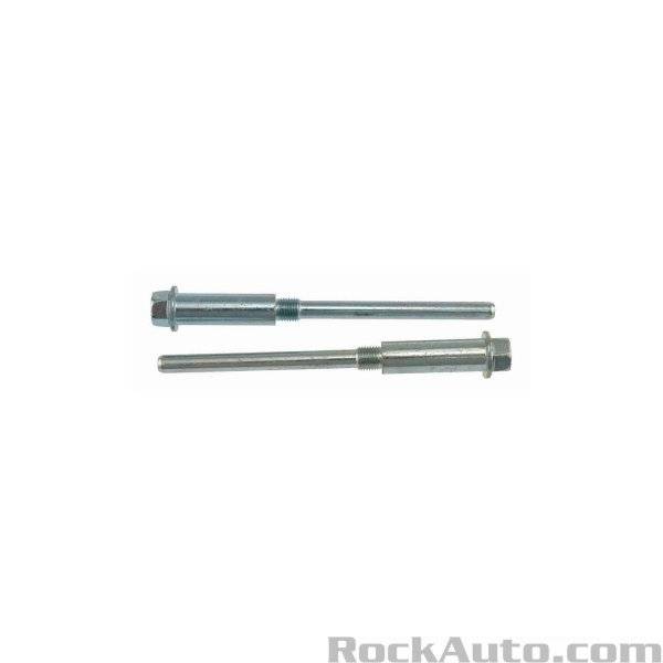

Your pins are not too long, that's the way they are, at least I think so. You can also buy the pins seperately if you're convinced they're too long
PINS
