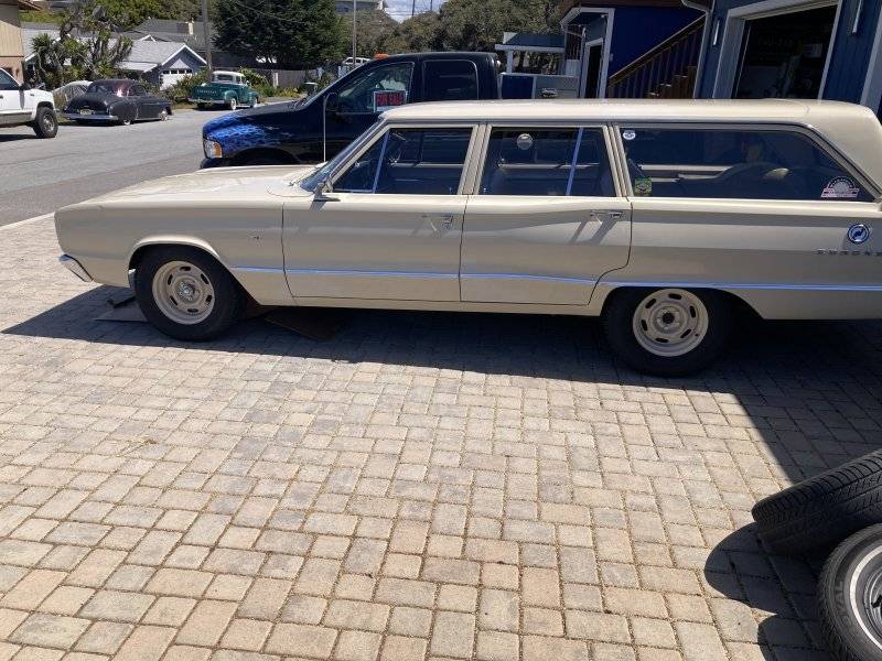

Welcome from the central coast of Cal. I have an SUV cousin as my daily driver. There are several things you can do for a little more zip. 4 of them you already mentioned. One thing to keep in mind though, when you add the go to it, add the whoa too. Very good idea to upgrade your braking.
