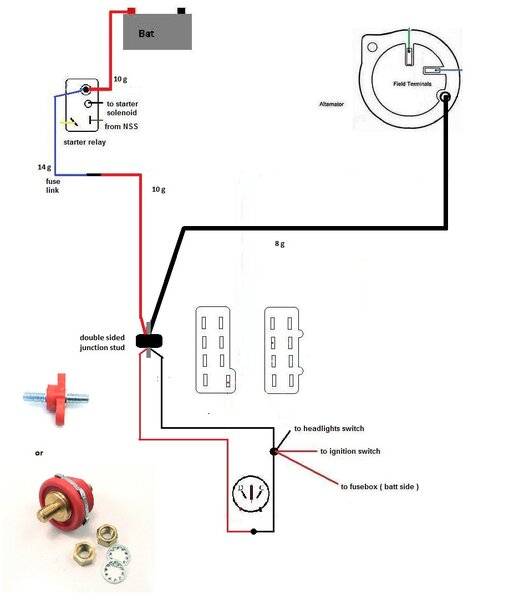

you don't use heater but if rains ( and I bet Florida gets LOT of rains on the respective season ) will use wipers and deff function.
On normal conditions you should be fine, but as mentioned, if you note some issue, you can make later to the next step
