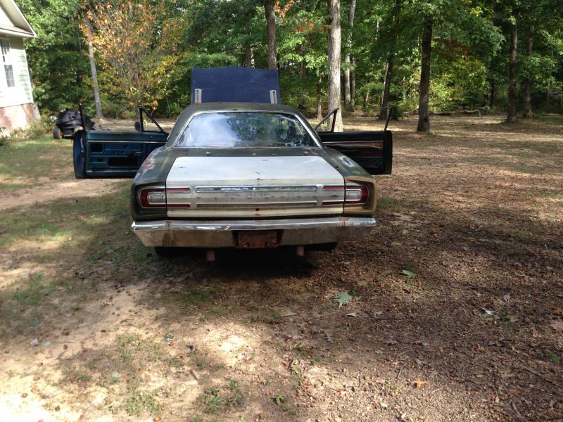

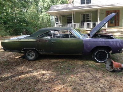

First project arrived at my home Thursday night. So I'm already starting out a little backward. I have the car first and now am starting the research part of the adventure.
As far as plans I'm working on figuring that part out. I know I want to keep the original look of the car. The car does not have a matching numbers engine and I'm struggling with the decision as to what to put in the car and whether to go with a 4 speed or automatic. I'm told it was originally an automatic but someone had put a manual transmission in it at one time. I believe the car was originally Dark Green with a vinyl top. Any advise is greatly appreciated. I hope to work on this with my two sons 15 and 12 Hope to finish the project within the next 2-4yrs. Not a show car just a really nice driver.

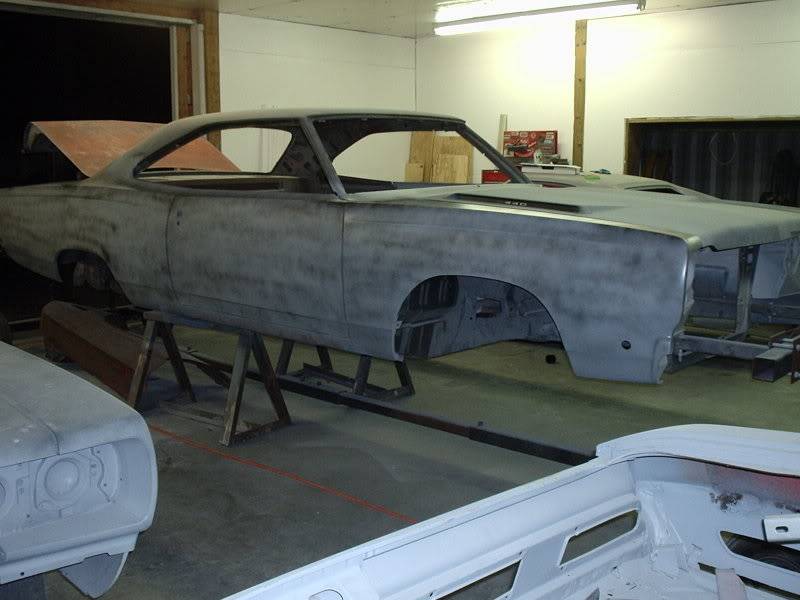

good luck with her............ here's mine

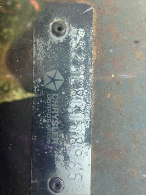

R=GTX
S= Special
23= 2door hardtop
L= 440 375HP 4 BBL 8 cylinder
G= assembled in St.Louis Missouri
178965 is the sequence #

Also look for a metal trim tag. It is located under the hood, on the driver side inner fender. It will have a bunch of numbers on it. If you have it, that is great - it will also tell you a lot about your car. To be sure it is the right tag, the bottom right numbers should match the sequence # 178965.

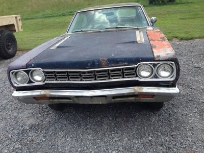

The entire front clip looks to be from multiple cars. The tags have been removed. What about the radiator support is there any useful information from that #?

Rad support won't tell you much other than the vin number. If you can't find the build sheet anywhere you can still find out a few things by playing detective. For instance, the original colour is probably still under the carpets. If it was originally an automatic you might find evidence of cooling lines at the radiator. If column shift, that'll be a clue. You can sometimes find traces of vinyl top under the stainless trim if it wasn't completely removed. There would also be evidence of holes for mounting the vinyl roof edging in the sail panel.

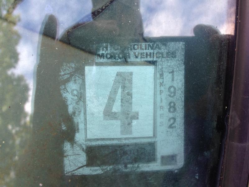

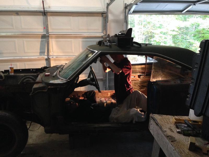

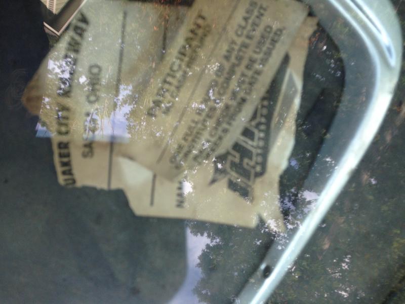

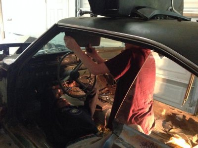

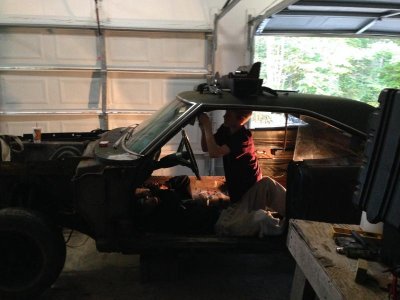

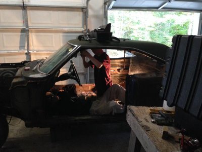

We had a somewhat productive first day. My sons and I have the Hood, Fenders, Trunk lid, Grill, both doors, and seats removed from the car. We have the car in the garage now so we can play in bad weather and have started attempting to remove the dash. Seems like a good day "But" Seems the entire car was taken apart at one time and put back with a 1/4 of the bolts and screws. Most of which never belonged with the car in the first place. Did not find the build sheet. Did find a ticket for a Drag Strip in North Carolina. Also has a sticker in the Window indicating that the car was in North Carolina in the early 80's. The car was definitely Dark Green with Dark Green and light Green interior.
Restoring what remains of one 1968 Plymouth who knows?
Watching the two dream about what it will look like "One Day" totally "priceless"

Careful with the dash. The windshield has to come out. Its bolted in where it meets the thw firewall. Thw windshield has to be out to access the bolts. Bummer about the build sheet. I have found them in front seats before. Under the upholstery. My fingers are crossed for you.
