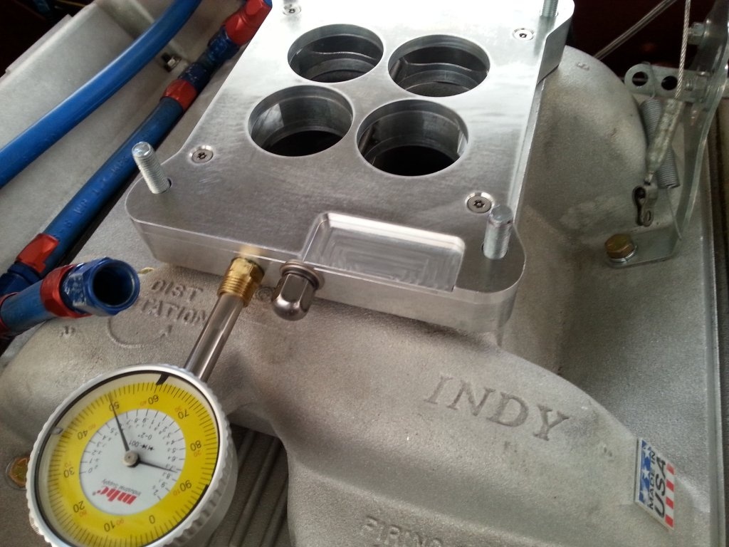

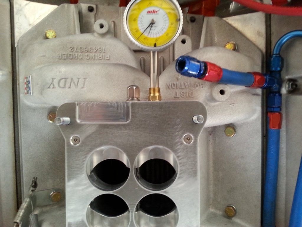

Here in California 75% of the racers running bracket classes use the ET Genie....including cars running in the 9.00 to 11.99 bracket and also the cars running in the 12.00 to 16.00 bracket.
Of the guys in A Gas (7.60 heads up), B Gas (8.60 heads up), C Gas (9.60 Heads up), D Gas (10.60 heads up) and E Gas (11.60 heads up) 100% of those guys run the ET Genie. Benefit is you run your car at full throttle but the ET Genie restricts the Air Flow and the motor thinks it is smaller and runs not as fast. You can keep track of the Air Density, temp, etc, etc, from race to race and check and see what setting you had on your ET Genie at your last race and adjust it from there to run almost EXACTLY THE same ET from race to race. Now...if you want to be serious about Bracket Racing and be consistant then you might consider spending the $400 bucks to do that...just saying.
rest 2 (2).jpg plate part closed.jpg View attachment 334705

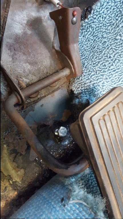

Fab a mount to use 3/8x24 bolt as a positive stop. Then learn how much movement it takes to slow it up. Won 2 championships and quite a few races in N/SS using this simple, cheap, and effective method.
