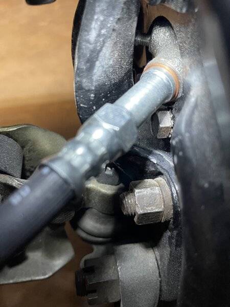

So this is really odd… these things are still leaking, at the input line….it stops, then leaks again. It’s really pissing me off to be sure, Chinese made ****. Any brand for cylinders and hoses ?
If you mean the hoses are leaking at the crimp were the metal fitting meets the rubber hose?
They are junk - must be replaced or you will very likely have a brake failure.
The hoses are new, and the leak is at the union of the cylinder and the hose,
If the copper washers are not punched out clean I have seen them with quite a burr on the edges that may not allow them to seal properly.
They normally seal or they don't.
