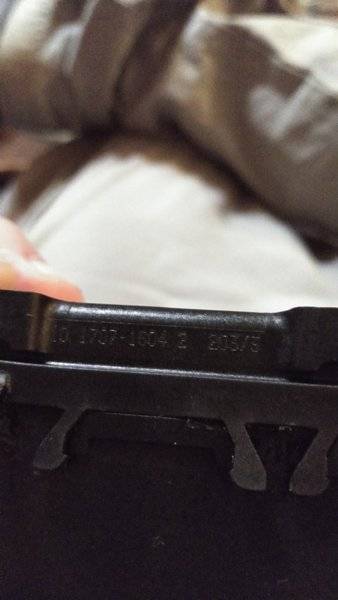

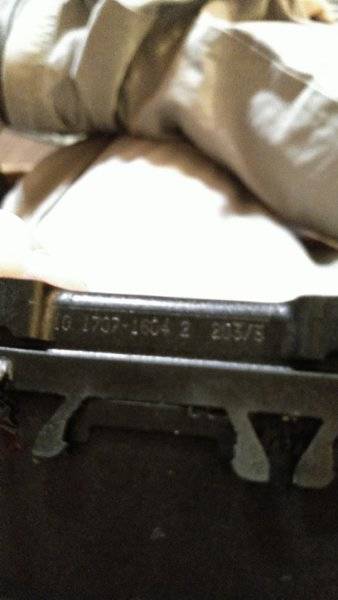

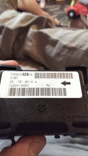

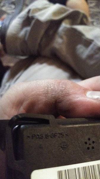

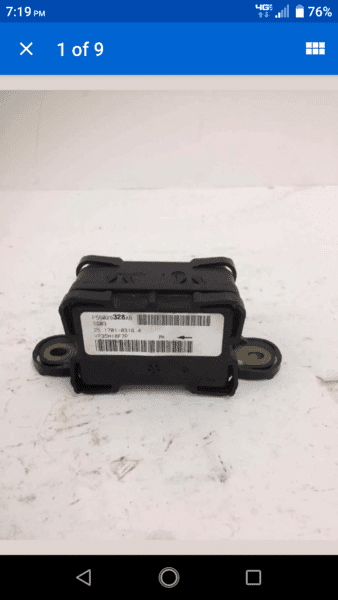

I found this on bay
But the numbers don't work on rock auto or AutoZone
Ok parts out and no one knows what it is all parts stores say no such thing what is the actual name for this most are saying stability control module .
Auto zone and o Riley says no such thing!!!

It's definitely bad it was leaking goo and has a burnt smell. I'm afraid to buy used asm has only 69000 miles on car .... but I think I just found one at dealer they want $800 for it!
So used it might be !
